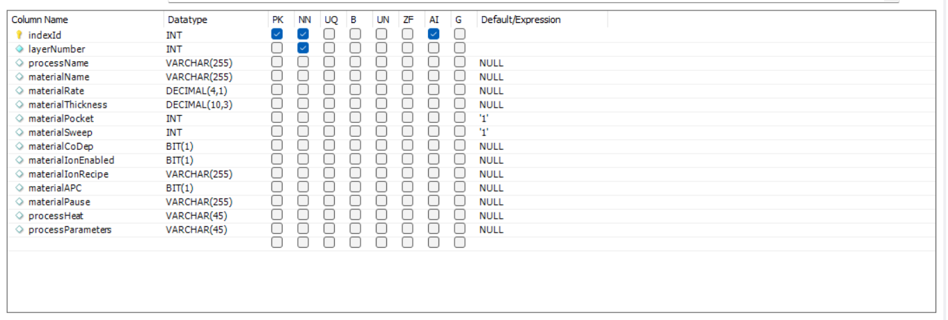

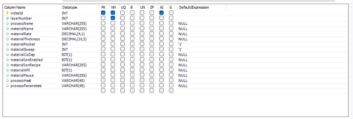

In the above code, I have a host of named queries running which are pulling recipe data relevant to the user-defined process. In total, there are roughly 5 different SQL tables that these are reading from, and each table might have 5-10 tags assigned to it. This is a manual transfer of data from the SQL tables into OPC tags for process control.
I figure there has to be a better way of doing this because I occasionally get unresponsive moments on my client. I’m assuming this is because of the amount of querying that’s going on? I’m looking for a way to group these queries by SQL table and shrink my total system.db.runNamedQuery to a handful. I figure this would help speed up my data transfer and not cause client issues.

**Post date:** [October 5, 2025, 3:19am UTC](https://forum.inductiveautomation.com/t/condensing-named-queries/111184/8 "2025-10-05T03:19:17Z")
Hopefully this helps illustrate what is going on:
The ‘Layer’ data is basic single “SELECT” - Ex: LAYER THICKNESS
 ![image](https://us1.discourse-cdn.com/inductiveautomation/original/3X/6/7/67d97fba5b2b9eb181b23dcdf68eaeeed27b7ecf.png)
These queries pull data from the SQL table into OPC tags for other functions:
 ![image](https://us1.discourse-cdn.com/inductiveautomation/original/3X/f/8/f823f39891af0ce259f2a912cbca55323c4445dd.png)
The ‘Mat’ data is the same:
 ![image](https://us1.discourse-cdn.com/inductiveautomation/original/3X/b/4/b4b331609001c77cc354574294e5e0ece258e103.png)
from a different table:
 ![image](https://us1.discourse-cdn.com/inductiveautomation/original/3X/f/4/f45cd923d5e9224e78ae3e41e082418c48e1a14e.png)
and the assist is more of the same but on a different table
So 3 different sql tables here, pulling 5-10 variables each. I like your idea of condensing these by making a list and using that list to create one query per table, so 3 NQ’s for the above. I will also look into the async function.
Really appreciate the input from anyone. This will get me started in the right direction but anything else after seeing these tables is also great.

**Author:** ![ryan.white](https://sea1.discourse-cdn.com/inductiveautomation/user_avatar/forum.inductiveautomation.com/ryan.white/32/73193_2.png) [@ryan.white](https://forum.inductiveautomation.com/u/ryan.white)\
**Post date:** [October 6, 2025, 4:36pm UTC](https://forum.inductiveautomation.com/t/condensing-named-queries/111184/10 "2025-10-06T16:36:47Z")
You can use [JOIN](https://www.w3schools.com/SQL/sql_join.asp)s to join data from two tables as long as they contain columns that are related to each other. (such as MaterialName in the two tables you have shown). For exmaple, something along the lines of:
```SQL
SELECT
	LayerNumber,
	ProcessName,
	userprocess.MaterialName,
	MaterialRate,
	MaterialThickness,
	MaterialPocket,
	MaterialSweep,
	MaterialCoDep,
	MaterialIonEnabled,
	MaterialAPC,
	MaterialPause,
	ProcessHeat,
	ProcessParameters,
	matAssist,
	matEBSource,
	matHighVoltage,
	matEmissionCurrent,
	matOxygen,
	matPocket,
	matSweep,
	matCrystal
FROM
	userprocess
WHERE
	ProcessName = :hmi_ActiveProcess
	AND layerNumber = :hmi_ActiveLayer
INNER JOIN(
	SELECT
		materialName,
		matAssist,
		matEBSource,
		matHighVoltage,
		matEmissionCurrent,
		matOxygen,
		matPocket,
		matSweep,
		matCrystal
	FROM
		usermaterials
) materials
ON materials.materialName = userprocess.materialname
Would give you the needed data from `userprocess` and `usermaterials`. Make sure you have indexes defined on the columns you will be using to join tables. You can also perform multiple joins in the same statement.
Looking more at your tables, namely the material table, what are `matOxygen`, `matEmissionCurrent` and `matHighVoltage` holding? Are they floating point numbers with a unit attached(ie 3.6kV)?

**Author:** ![warren](https://avatars.discourse-cdn.com/v4/letter/w/97f17d/32.png) [@warren](https://forum.inductiveautomation.com/u/warren)\
**Post date:** [October 6, 2025, 4:56pm UTC](https://forum.inductiveautomation.com/t/condensing-named-queries/111184/12 "2025-10-06T16:56:47Z")
Hi Ryan,
**What are `matOxygen`, `matEmissionCurrent` and `matHighVoltage` holding?**
Yes these are holding floating point numbers attached to OPC tags to control PLC outputs, like 3.6kV = 10ma, or 2.5sccm = 1VDC
