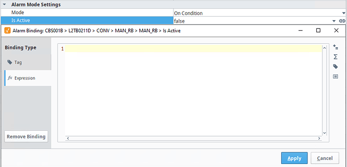

I'm attempting to set the "Is Active" expression binding (below) from a script, when in "Mode" is set to "On Condition".
 ![image](https://us1.discourse-cdn.com/inductiveautomation/original/3X/8/d/8da87778ae768c21ff3897f1706d2da9c3aff94a.png)
I understand the "Is Active" property name is named `activeCondition` in scripting, however this is a Boolean value, and I can't seem to write an expression written to it. Is there a way to write to the expression binding from a script, similar to the format below, where `activeConditionExpression` is the scripting name for the "Is Active" expression binding and `myExpression` is the expression I wish to write to this binding?

I suggest you add an expression normally and then export the tag's json and have a look at what the value of that prop is. You will need to follow suit and use `system.tag.configure` to write the config change back to the tag. Ensure that you set the mode to _merge_ changes, _not to overwrite_ them.
e.g.
Example tag JSON with manually configured (bogus) expression:
tagpath: [default]System/New Tag
```python
  "valueSource": "memory",
  "alarms": [
      "mode": "OnCondition",
      "name": "Alarm",
      "activeCondition": {
        "bindType": "Expression",
        "value": "if({tag}, 5, False)"
  "name": "New Tag",
  "tagType": "AtomicTag"
Script to reconfigure it:
```python
cfg = [{
  "name": "New Tag",
  "alarms": [
      "name": "Alarm",
        "value": "{OtherTag} = 10"
folderPath = '[default]System'
system.tag.configure(basePath=folderPath,
	tags=cfg,
	collisionPolicy='m'
Notes:
- the tag defs must contain at a minimum the `name` key
- all included property values must be complete, not partials. I.e. structures like `alarms`, `writePermissions`, etc. values cannot be provided as partials and _merged_, they must contain the entire structural definitions

Thank you very much, exporting to JSON first to get the formatting worked a treat!
