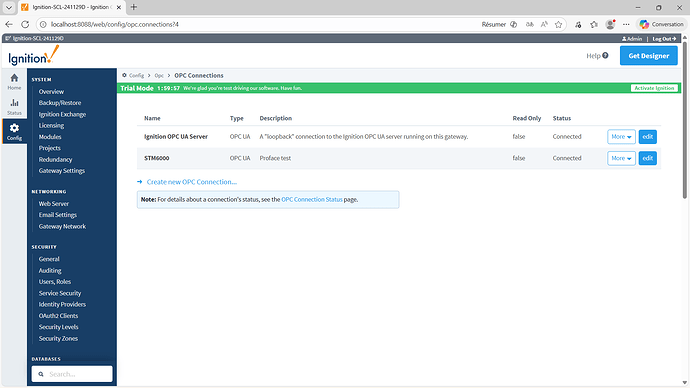

Hello!
I’m trying to connect a Proface STM6000 to Ignition.
This system is OPC-UA server. I can check the connexion succesfully using UAExpert.
But the connexion to Ignition is not stable. Maybe a link configuration problem?
Has anyone already worked on this product?
Thanks for your help!

**Author:** ![olivier.roberge](https://avatars.discourse-cdn.com/v4/letter/o/6f9a4e/32.png) [@olivier.roberge](https://forum.inductiveautomation.com/u/olivier.roberge)\
**Post date:** [February 5, 2026, 10:33am UTC](https://forum.inductiveautomation.com/t/connecting-proface-stm6000/113758/5 "2026-02-05T10:33:25Z")
I tried OPCUA configuration as you are suggesting.
In this case connexion is stable, but I cannot see any variable in the browser (no security option selected on both side).
**Post date:** [February 6, 2026, 12:41pm UTC](https://forum.inductiveautomation.com/t/connecting-proface-stm6000/113758/11 "2026-02-06T12:41:12Z")
Yes, perfect.
