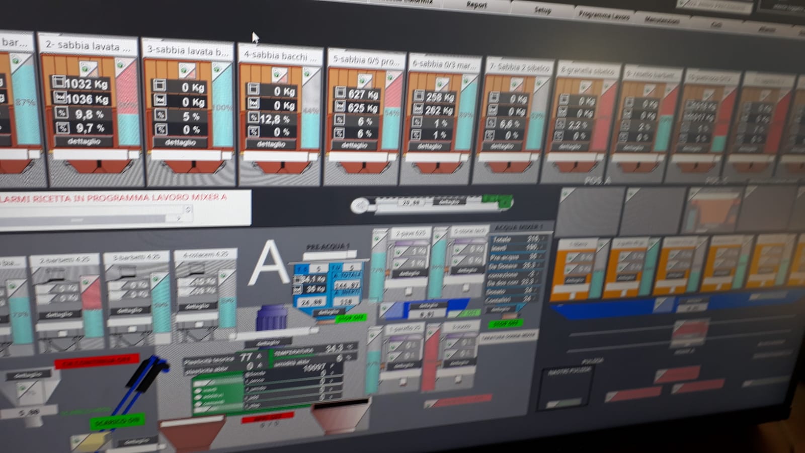

Goodmorning,
sometimes, when open client, some control that use PLC tag, have a green icon, as if the tag of control don’t communicate with Siemens PLC: control don’t work properly.
But in the gateway, Siemens PLC connection is ok and database connection is ok.
what may be the reason???
Thank you
Bye
 ![1658471660213](https://us1.discourse-cdn.com/inductiveautomation/original/3X/9/9/99b27b6e73b84bf1fab3a7821c24ebd244d8ce67.jpeg)
 ![1658471660253](https://us1.discourse-cdn.com/inductiveautomation/original/3X/3/2/32b8d7ab01ed2bd3016a7ea968fbcac52383ed6d.jpeg)

This green icon represents UNCERTAIN value like table:
 ![image](https://us1.discourse-cdn.com/inductiveautomation/original/3X/f/2/f28242dc758c400e399214e201af51f85dbb2559.png)
Check the browser tag list to check the diagnostics of each tag, or there must be something on the network that is causing to lose communication to PLC. Have you checked that the communication of the Client to PLC is always active and that no packets are lost?

Ah ok, if you launch runtime from designer, PLC tags in tag browser , what quality code have ?
**Author:** ![stefano.sforna](https://avatars.discourse-cdn.com/v4/letter/s/91b2a8/32.png) [@stefano.sforna](https://forum.inductiveautomation.com/u/stefano.sforna)\
**Post date:** [July 25, 2022, 6:06am UTC](https://forum.inductiveautomation.com/t/connection-with-tag/62197/19 "2022-07-25T06:06:02Z")
I don’t see quality code of tags, but value of tags were written in italics, in different way
**Author:** ![m.pelagatti](https://sea1.discourse-cdn.com/inductiveautomation/user_avatar/forum.inductiveautomation.com/m.pelagatti/32/68595_2.png) [@m.pelagatti](https://forum.inductiveautomation.com/u/m.pelagatti)\
**Post date:** [July 25, 2022, 6:21am UTC](https://forum.inductiveautomation.com/t/connection-with-tag/62197/20 "2022-07-25T06:21:34Z")
Ok , italic is when lost connection. In Gateway/logs have you seen what error come out?
