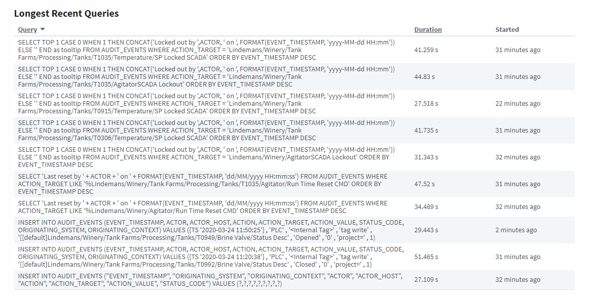

**Post date:** [March 24, 2020, 12:55am UTC](https://forum.inductiveautomation.com/t/constant-database-connection-faulted-errors-in-gateway-log/33340/5 "2020-03-24T00:55:27Z")
There haven’t been any faults since changing the config for 3 hours now, so this is possibly resolved in terms of the crashing.
These are from longest queries just now. Some seem overly long… INSERT shouldn’t take 51s to execute
 ![image](https://us1.discourse-cdn.com/inductiveautomation/original/2X/1/1c6a83605cd8efd0228231df0df371a2a2380ef1.png)
**Post date:** [March 24, 2020, 10:48am UTC](https://forum.inductiveautomation.com/t/constant-database-connection-faulted-errors-in-gateway-log/33340/6 "2020-03-24T10:48:56Z")
Seems to me you want to ensure indices on event\_timestamp and action\_target.

**Post date:** [March 24, 2020, 12:42pm UTC](https://forum.inductiveautomation.com/t/constant-database-connection-faulted-errors-in-gateway-log/33340/7 "2020-03-24T12:42:20Z")
FWIW I do not feel that the duration given in my Longest Recent Query list are accurate and do not pay them much mind.
I often see entries that list a query duration as 30 minutes and started 20 minutes ago, things like that. If the variables were listed in Named queries rather than just logging the “?” it would make troubleshooting easier. But as-is I cannot believe some of the times I see recorded there. I cannot come close to replicating them via spot checks.
