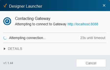

Hey all, I was I/O testing today and closed my laptop lid when I was done. I reopened it because we wanted to test one more thing. It wouldn't load so I shut down and rebooted. Now, when I try to launch my designer or localhost, it can't connect. I'm scared I just lost all of my completed work over the last several months. Any tips?
I should also note, I CAN connect to a second server we have, just not the one where all of my data is.
 ![ignitionissue](https://us1.discourse-cdn.com/inductiveautomation/original/3X/1/3/132991bb43e2702401670a4d854d72b2da89eaf4.png)
I did some more digging and got into the wrapper log which tells me this. Can't say I really understand any of it:

> INFO | jvm 1 | 2025/06/19 13:24:29 | WrapperSimpleApp Error: java.io.IOException: Failed to bind to 0.0.0.0/0.0.0.0:8088
This just means the Ignition Gateway failed to start because something else is already bound to port 8088.
It could be that you need to reboot, or it could be other software you have installed. `netstat -ab` as Administrator might show you what process is bound to that port.

Do you know if there's a way to change the gateway port without affecting anything? I'm struggling to find what other software is using 8088.
