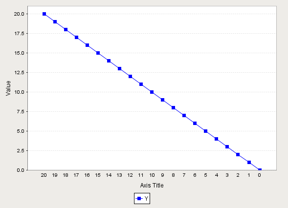

Hi All,
Is there a way to have a contrariwise Chart’s X axis?
I have two charts. One is displaying the rise of a variable ( from 0 to 50 degrees ) and the other chart should display the fall of the same variable ( from 50 to 0 degrees ) but I can’t find a clean way to reverse the X axis in order to have it from 50 to 0.
**Post date:** [October 22, 2018, 5:29pm UTC](https://forum.inductiveautomation.com/t/contrariwise-charts-x-axis/20293/2 "2018-10-22T17:29:14Z")
You can do this with a category chart. The labels are then in order they appear in the dataset.
![](https://us1.discourse-cdn.com/inductiveautomation/original/2X/7/727160e2cfb2f7501547ce3c3636106be73e1225.png)

In the configureChart do the following:
```auto
plot =chart.getPlot()
domainAxis = plot.getDomainAxis()
domainAxis.setInverted(True)

Thaaaankksssss!!!
It worked like a charm! 😍
