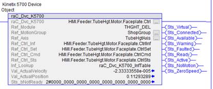

As an update to your questions
_Are you pointing at any members of AOI tags? Or include AOI data structures within your UDTs?_
This is a snippet for the PLC program. The top level parent UDT is the UST called HMI. All communications between the Ignition project and the PLC go through this UST.
 ![A screenshot of a computer AI-generated content may be incorrect.](https://us1.discourse-cdn.com/inductiveautomation/original/3X/d/4/d4b9d94e638ee870b03809be44ca2a792e3f938b.jpeg)
_Do you include any I/O data types within your UDTs?_
This is a snippet from the controller tags. The other UDT’s are very similar to this.
 ![A screenshot of a computer AI-generated content may be incorrect.](https://us1.discourse-cdn.com/inductiveautomation/original/3X/6/7/6793ea3f20134a6aad5291ee3925c9bd436ea717.jpeg)

**Post date:** [November 13, 2025, 6:36pm UTC](https://forum.inductiveautomation.com/t/controllogix-msg-class-3-utilization-swings-widely-why/86910/27 "2025-11-13T18:36:01Z")
> [@tricky](#):
Yeah, you are pointing IA's driver at a huge AOI. Performance will suck.
Looks like part of PlantPax. If PlantPax v5, then performance will suck using anyone's driver, as those objects are unfixably unoptimizable. (Even Rockwell's proprietary methods will choke on this.)
If PlantPax v4, and you have access to the source (unsealed AOIs), then you may be able to fix this to be optimizable with my driver (won't help the native driver). PlantPax commonly includes I/O data types directly in AOIs--you would have to re-engineer those, too.
In your review of the Best Practice topics, did you not notice the warnings about PlantPax?

**Post date:** [November 14, 2025, 2:03pm UTC](https://forum.inductiveautomation.com/t/controllogix-msg-class-3-utilization-swings-widely-why/86910/38 "2025-11-14T14:03:11Z")
No. AOI structures are substantially more complicated than simple UDTs, and Rockwell's Data Access manual explicitly tells users to not access them. IA avoids reverse engineering, and basically follows the Rockwell guidance.
I am perfectly happy to go beyond Rockwell's guidance in my own driver.
The other factor is external access to UDT and AOI members. If **any** member's external access is "None", the entire structure cannot be optimized. This applies to both my driver and IA's driver. AOIs often have such members, and if sealed, cannot be fixed. PlantPax5 built-in instructions have this problem, along with a few Function Block instructions and message instructions and IO data types.
