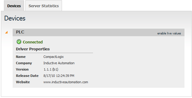

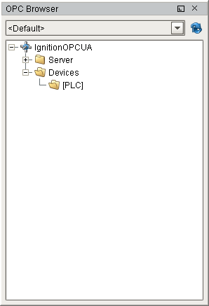

Im experiencing the same issue with a CompactLogix in which program I have defined some UDT’s. No IP conflict and no problem with RSLinx at all. What can be happening? ![:scratch:](https://us1.discourse-cdn.com/inductiveautomation/original/1X/76d1620bec252bfac07050c889ff5a91dc8a9c25.gif ":scratch:")
**Post date:** [August 17, 2010, 3:35pm UTC](https://forum.inductiveautomation.com/t/contrologix-tags-not-showing-up/2098/11 "2010-08-17T15:35:22Z")
And this is after pressing the [refresh browse] button next to the device in the device configuration area on the gateway?
**Author:** ![StriderPR](https://avatars.discourse-cdn.com/v4/letter/s/838e76/32.png) [@StriderPR](https://forum.inductiveautomation.com/u/StriderPR)\
**Post date:** [August 17, 2010, 4:26pm UTC](https://forum.inductiveautomation.com/t/contrologix-tags-not-showing-up/2098/12 "2010-08-17T16:26:30Z")
Yes! I did the browse refresh and nothing. Attached some images.
 ![](https://us1.discourse-cdn.com/inductiveautomation/original/1X/e10136ed5b4cc866bc98427da403c1d21e1392e0.png)
 ![](https://us1.discourse-cdn.com/inductiveautomation/original/1X/069fb076e363ebf31ff4356bc251d7d5bdb7322f.png)

**Author:** ![Travis.Cox](https://avatars.discourse-cdn.com/v4/letter/t/b9bd4f/32.png) [@Travis.Cox](https://forum.inductiveautomation.com/u/Travis.Cox)\
**Post date:** [August 17, 2010, 6:22pm UTC](https://forum.inductiveautomation.com/t/contrologix-tags-not-showing-up/2098/15 "2010-08-17T18:22:32Z")
From looking at the system we had to do a Refresh Browse on the device in order for the tags to show up.
