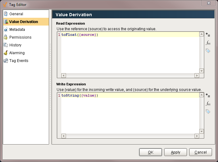

**Author:** ![witman](https://avatars.discourse-cdn.com/v4/letter/w/d2c977/32.png) [@witman](https://forum.inductiveautomation.com/u/witman)\
**Post date:** [June 7, 2019, 7:41am UTC](https://forum.inductiveautomation.com/t/convert-mqtt-created-string-tags-to-number/25621/8 "2019-06-07T07:41:19Z")
If position is a read/write value (rather than read-only), a derived tag would do the job like this:
 ![image](https://us1.discourse-cdn.com/inductiveautomation/original/2X/c/caec6e888de11c04025bd52643011cd698a73ae9.png)
I’m guessing there’s a setting somewhere that determines whether you can write to the MQTT tags and you’re getting the error because they are read-only. They’d need to be setup to allowing publishing to them, rather than just subscribing.
