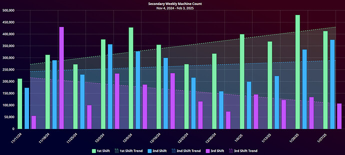

I have developed several interfaces in our MES that have an "Export to Excel" button that takes Table data and turns it into Excel. I now have some XY Charts that I would like to offer a similar "Export to PDF" feature for. I know this could be done via the Report Component XY Chart, but it looks very different programmatically from the Perspective XY Chart. It took me a while to learn the format of the Perspective version, and before I delve into understanding the format of the Report Component version I figured I should ask if anyone might have some pointers on how to go about it...
**Post date:** [February 7, 2025, 8:59pm UTC](https://forum.inductiveautomation.com/t/convert-perspective-xy-chart-to-report-component-xy-chart/102056/2 "2025-02-07T20:59:41Z")
Teach yourself with Vision's Classic Chart, so you can see results near-instantly. The reporting module uses JFreeChart just like Vision.
**Author:** ![Ryan\_Deardorff](https://sea1.discourse-cdn.com/inductiveautomation/user_avatar/forum.inductiveautomation.com/ryan_deardorff/32/63815_2.png) [@Ryan\_Deardorff](https://forum.inductiveautomation.com/u/Ryan_Deardorff)\
**Post date:** [February 7, 2025, 11:22pm UTC](https://forum.inductiveautomation.com/t/convert-perspective-xy-chart-to-report-component-xy-chart/102056/3 "2025-02-07T23:22:56Z")
I have it mostly figured out, except for how to get the bars not to overlap. I'm trying to recreate:
 ![image](https://us1.discourse-cdn.com/inductiveautomation/original/3X/3/3/33978974d8b679e1fb85d27a2a208833c52eeb46.jpeg)
...but it looks like:
 ![image](https://us1.discourse-cdn.com/inductiveautomation/original/3X/c/c/cc54c296982fe8252793e283c8b85cf4f63b1ea8.png)
Is this possible, or I do have to use lines instead of bars?
