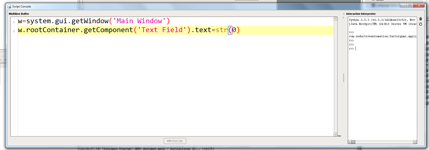

I am doing something very simple. I am trying to assign a number to a text field component in the script console. When I try to convert to a string and then assign, the script console freezes along with the designer. Assigning a string works correctly.
Is this a bug? Can anyone reproduce the problem?
 ![](https://us1.discourse-cdn.com/inductiveautomation/original/2X/f/f05d1a2b763f6ea1f64e50ee48fcf6cba815e5c3.png)
![](https://us1.discourse-cdn.com/inductiveautomation/original/2X/9/9dc177e3b9bcf7dc95e0200210d4a296ee7d7adb.png)
UPDATE:
Just tried with a numeric text field and encountered the same problem, assigning a number without conversion to string.

Does it work if you do the assignment inside something you used `system.util.invokeLater` on?

Yes, doing the following works without issue.
NOTE: changed text field name to `output`
```auto
import random
def do_it():
	w=system.gui.getWindow('Main Window')
	c=w.rootContainer.getComponent('output')
	c.text = str( random.randint(0,100) )
#do_it()
system.util.invokeLater(do_it)
**Post date:** [November 21, 2018, 10:00pm UTC](https://forum.inductiveautomation.com/t/converting-number-to-string-and-assigning-to-component-in-script-console-bug/21009/4 "2018-11-21T22:00:28Z")
Alright, well… there’s a bug, but it’s in your script 😉
The script console executes code in a worker thread, not on the UI thread, which makes any manipulation of the UI off limits unless you throw it into an `invokeLater` so it gets run on the UI thread.
