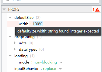

**Author:** ![taohongyu88](https://avatars.discourse-cdn.com/v4/letter/t/f05b48/32.png) [@taohongyu88](https://forum.inductiveautomation.com/u/taohongyu88)\
**Post date:** [September 11, 2025, 6:32am UTC](https://forum.inductiveautomation.com/t/coordinate-container/110507/3 "2025-09-11T06:32:42Z")
![image](https://us1.discourse-cdn.com/inductiveautomation/original/3X/c/d/cde918d74e713dd59454f8e430f5d6a843ed014d.png)
Coordinate Container‘s height or width must be integer.
**Author:** ![pascal.fragnoud](https://sea1.discourse-cdn.com/inductiveautomation/user_avatar/forum.inductiveautomation.com/pascal.fragnoud/32/24728_2.png) [@pascal.fragnoud](https://forum.inductiveautomation.com/u/pascal.fragnoud)\
**Post date:** [September 11, 2025, 6:52am UTC](https://forum.inductiveautomation.com/t/coordinate-container/110507/4 "2025-09-11T06:52:21Z")
That's not the right properties.
Select whatever component needs to stretch, and find its `position` properties.
They have width and height properties:
 ![image](https://us1.discourse-cdn.com/inductiveautomation/original/3X/6/b/6b881005234357063b05d7549d0736132875015e.png)
`calc` raises a warning, but it works... Maybe there's a way to suppress that warning, I'm not sure.

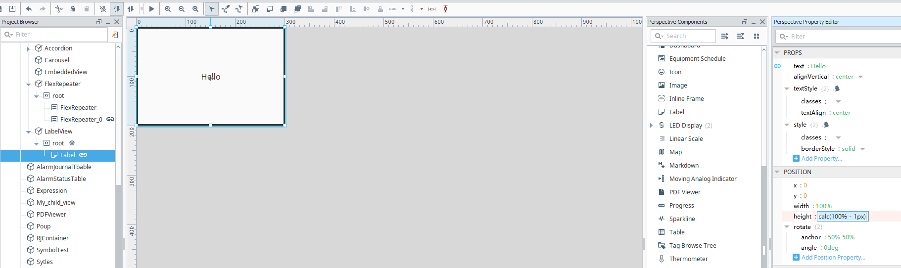

**Post date:** [September 11, 2025, 12:12pm UTC](https://forum.inductiveautomation.com/t/coordinate-container/110507/5 "2025-09-11T12:12:39Z")
Yeah, If I have just one component, such as you you write, it can resize.
 ![image](https://us1.discourse-cdn.com/inductiveautomation/original/3X/2/1/219afd9342c48d9874d2e598a176e46135498b7c.png)
But If I have many components , I can’t set every component’s width , is there other easy way?
**Post date:** [September 11, 2025, 12:24pm UTC](https://forum.inductiveautomation.com/t/coordinate-container/110507/6 "2025-09-11T12:24:45Z")
> [@taohongyu88](#):
Why not ?
The alternative is to use a flex container instead.
