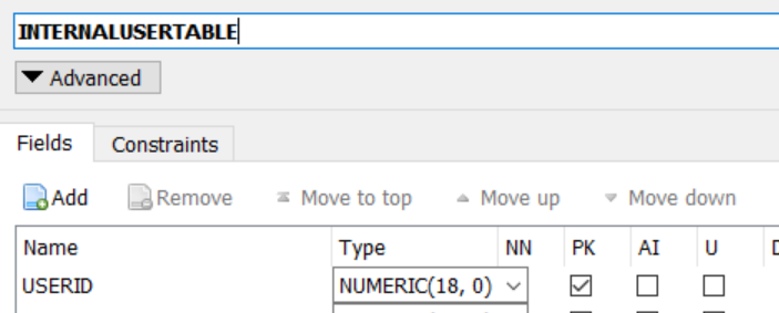

Hi guys, bit of a curious problem.
I've copied the following tables over during a migration, everything worked out, roles where preserved, users could log in etc.
 ![image](https://us1.discourse-cdn.com/inductiveautomation/original/3X/f/7/f709a2d18dc12539f3ca8b064c3a9fb14302dfe5.png)
However, when I want to create a new user, I'm getting this error:
 ![image](https://us1.discourse-cdn.com/inductiveautomation/original/3X/1/0/10a8a67a3c4c6ac86a3391e8d6c2e35fa654a7e6.png)
 ![image](https://us1.discourse-cdn.com/inductiveautomation/original/3X/6/2/62f5bae24546300f8c0e4cd5521fee9e4e4194f8.jpeg)
After some digging, I realized the ID is not an autoincrement field, although I think it should be 🙂
 ![image](https://us1.discourse-cdn.com/inductiveautomation/original/3X/1/2/12a6df28d10e0112ed35d4d36d7ace8238db0f8a.png)
Any idea where is ignition getting the user ID from? Is there some table that I'm missing? or does the AI need to be reset?
Thanks!!
**Post date:** [April 12, 2023, 12:32pm UTC](https://forum.inductiveautomation.com/t/copied-internal-user-tables-over-now-primary-key-constraint-failling-when-adding-new-user/72345/2 "2023-04-12T12:32:08Z")
Look at and update the correct row in the `SEQUENCES` table. Ignition doesn't use the autoincrement column type, probably because the SQLite docs suggest to not.

Thanks! I missed that, didn't know SQLite don't recommend autoincrements, learned something new!
