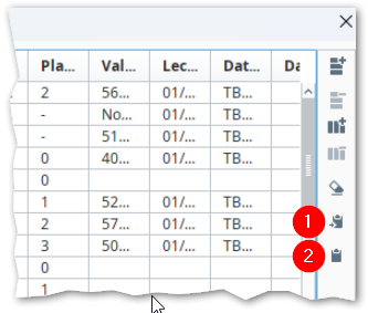

Hello!
Transforming Ignition designer proyect into Ignition Perspective.
How can I use data from dataset editor in Designer in a table in Perspective
 ![image](https://us1.discourse-cdn.com/inductiveautomation/original/3X/5/2/52917f9c0e42b51e219e75342597ceac49861b19.png)
![image](https://us1.discourse-cdn.com/inductiveautomation/original/3X/e/a/ea8a0cac3a3975fc6914025f7d67de09578b1232.png)
**Post date:** [April 22, 2024, 10:57am UTC](https://forum.inductiveautomation.com/t/copy-data-from-dataset-editor-into-perspective-table/89196/2 "2024-04-22T10:57:30Z")
> Transforming Ignition **designer** project into Ignition Perspective.
1. Do you mean that you're transforming an Ignition **Vision** project to Perspective?
2. What is the source of the data in the Dataset Editor? Is it fixed data or does it come from a query?

1.-Yes
2.-Fixed data

A minor shortcoming of Designer is that there is no simple way to create or paste a dataset onto a table.
Try this:
1. Copy the code below and paste it into your view or container. It will create a table with a dataset.
> **Table with dataset**

1. Open the Vision dataset and copy (1).
2. On the Perspective table open the dataset on `props.data` and paste in your Vision dataset (2).

Paste it as Configure Script / Custom Method into my persepective table ?

If you read the "Table with dataset" you can see that it is a table definition.
Paste it into the Perspective view. It will create a new table with a sample dataset.

Great, it works! thanks Transistor.
