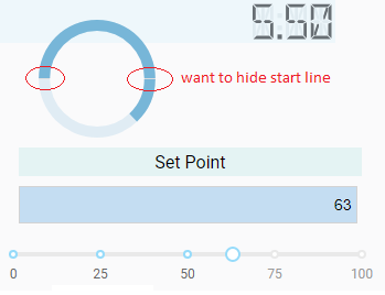

Hi
I need to create donuts gauge in perspective which is not available in components right now.
One solution I can think of use two simple gauge to create one donuts gauge. (one rotate in 180 degree)
The problem is each simple gauge has a start white line at beginning of gauge as shown in below which is not desirable here.
 ![image](https://us1.discourse-cdn.com/inductiveautomation/original/2X/0/0f72e788a4f19b07f5eec79dac697e50407dca34.png)
How I can hide the line?
Is there any other solution to create donuts gauge?

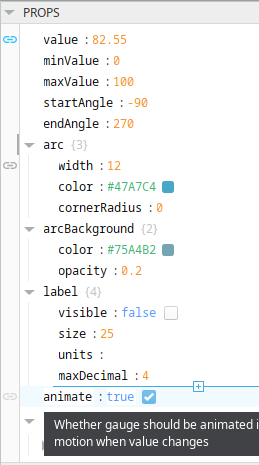

You should be able to do it using one gauge and adjust the start and end angles(Pick whatever angle you want to start at, then add 360 for the end angle. You still will likely have the start line though, but unless the gauge is at 100% it won’t be noticeable.

Thanks. I just need to adjust the label(vale). Is there a solution to move the label? In donuts shape the label position is incorrect.
**Author:** ![grietveld](https://sea1.discourse-cdn.com/inductiveautomation/user_avatar/forum.inductiveautomation.com/grietveld/32/6984_2.png) [@grietveld](https://forum.inductiveautomation.com/u/grietveld)\
**Post date:** [May 29, 2019, 11:45am UTC](https://forum.inductiveautomation.com/t/create-donuts-gauge-from-simple-gauge-in-perspective/25332/4 "2019-05-29T11:45:44Z")
Unfortunately not. I disabled the label, and put my own in the middle.

Not sure how to do it with a style since the properties are buried a bit, but arc → color and arcBackground -\>Color will adjust the color of the gauge.
