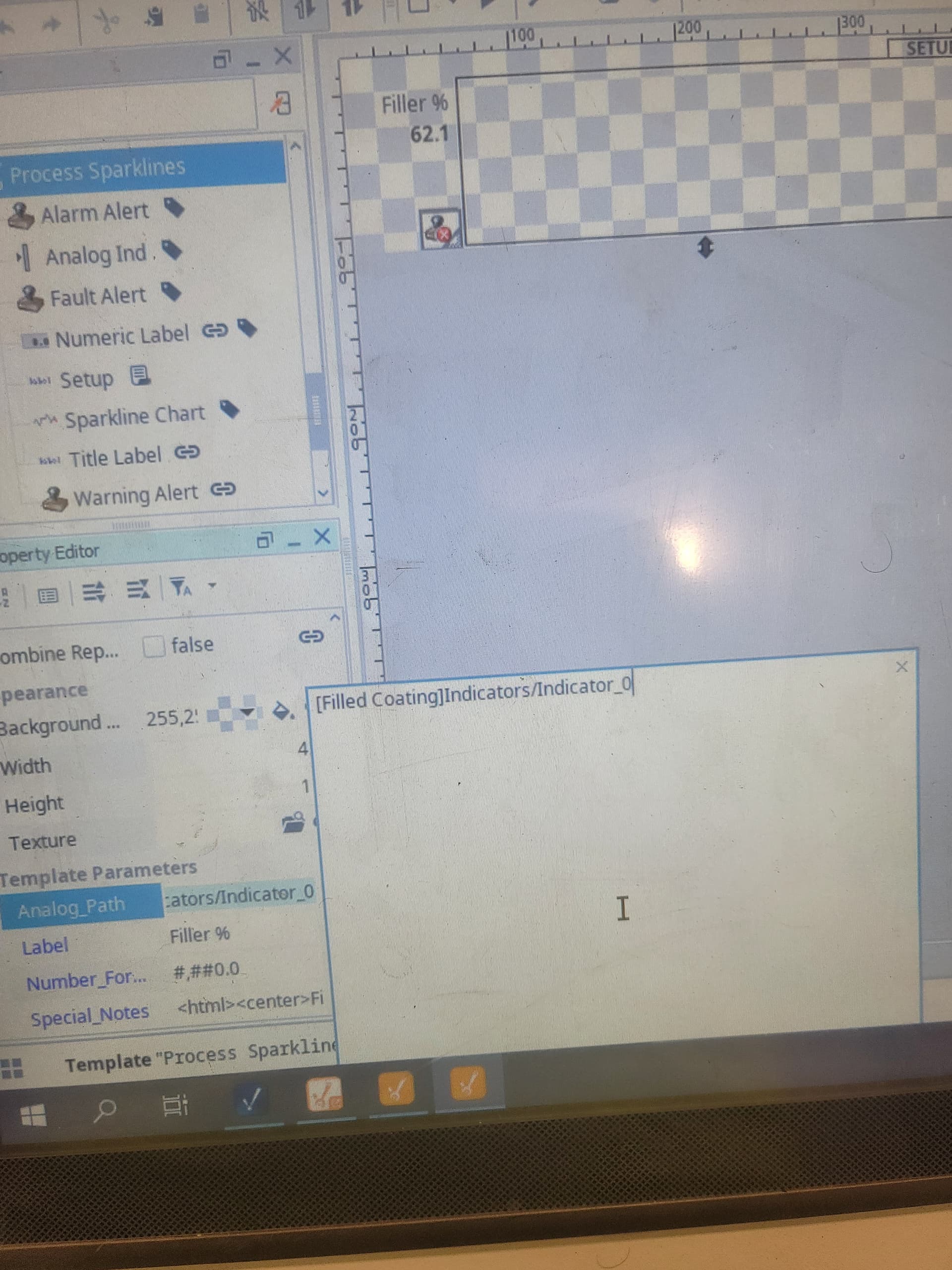

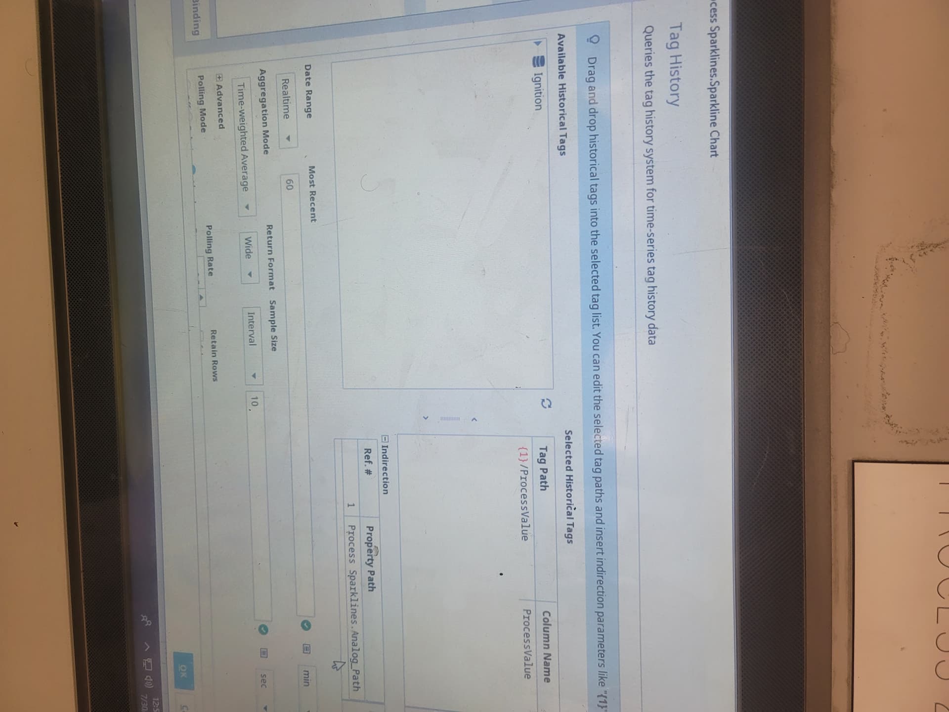

**Post date:** [July 30, 2025, 4:55pm UTC](https://forum.inductiveautomation.com/t/create-easy-chart-pen-tags-from-udt-in-template/109096/9 "2025-07-30T16:55:06Z")
Heres a template with a sparkline...same pricinple. The property analog\_path holds the tag path to the udt root. The sparkline uses an indirect to tag history. For an easy chart, youll use cell update bindings instead to update the pens.

While this doesn't get the Tag Path directly from the underlying template UDT, it does solve my problem for the most part.
I was able to create 2 Template Parameters (Strings) that hold the Tag Path of the 2 pens in my template Easy Chart. The only other Template Parameter I have is the TagInstance, which is the binding to the UDT tag for the template. These 2 new Template Properties are Strings so I have to figure out what the Tag Paths are and enter them here, but I wish there were a way to browse for History Tag Paths like there is for tags and properties.
