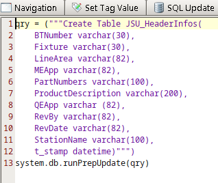

How does a datetime need to be put in to Create a Table with script. This is my script but it hates the datetime setup.
 ![image](https://us1.discourse-cdn.com/inductiveautomation/original/3X/2/8/28c06f8fa5ec44f85566d4eb317a73926de237e6.png)

Try delete the first open parenthesis, then move the last triple quotes to the right of the close parenthesis, like this:
```auto
qry = """Create Table JSU_HeaderInfos(
column1 datatype1,
column2 datatype2,
columnN datatypeN)"""

The actual query setup works but using datetime or date does not make the query happy. The rest of it works when omitting t\_stamp.

So I figured out the issue creating the table but i still need help creating and adding folders and tags using script to the default tag db.

Missing parenthesis at the end and the quotes needed moved outside of the first set.
 ![image](https://us1.discourse-cdn.com/inductiveautomation/original/3X/f/f/ff1991c0210fef9680af029d8c34593e6a962cf6.png)

That's exactly what @ajdewhirst1 told you to do ! hint: You don't need the outer parentheses.
