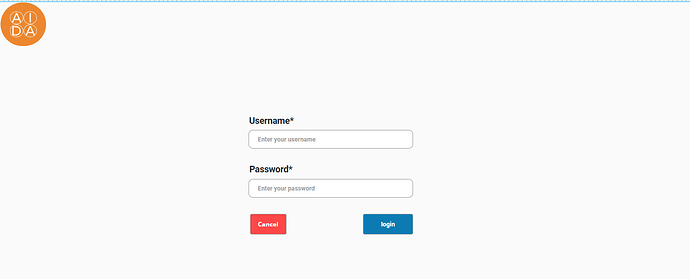

I created the login page with my own, using Perspective.
 ![image](https://us1.discourse-cdn.com/inductiveautomation/original/3X/6/b/6b933a262c24a55881189a162f45f380c07d4ea2.png)

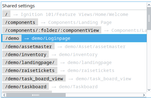

I need to make authentication for the above login page. Like when the user gives the correct credentials, then only the user moves into my project.
There are some URLs with views, but all the URLs can be viewed using the browser URL; restrict all the URLs. Refer to the screenshot below.
 ![image](https://us1.discourse-cdn.com/inductiveautomation/original/3X/f/9/f9b3a04a7c8366fb991eafefba2ac783a23224f0.png)

Don't make your own login system, its already part of Ignition.
> **[Component and Window Security Video at Inductive University](https://inductiveuniversity.com/videos/component-and-window-security/7.9)**
> Learn how to set up security on several components and show various levels of permissions and restrictions. Component security works on the component, group, container, and window levels.
Use the tools that already exist to configure authentication and window restrictions.

For a bit more context, you cannot force a login in perspective via scripting functions to log into an identity provider. This would be a huge security hole. Identity providers provide their own login screens, including Ignition's own default IdP. If you try to create something yourself using Perspective, you will be building a security model that can only ever be half baked while also missing out on using most of the security features Ignition offers for things like tag permissions etc
