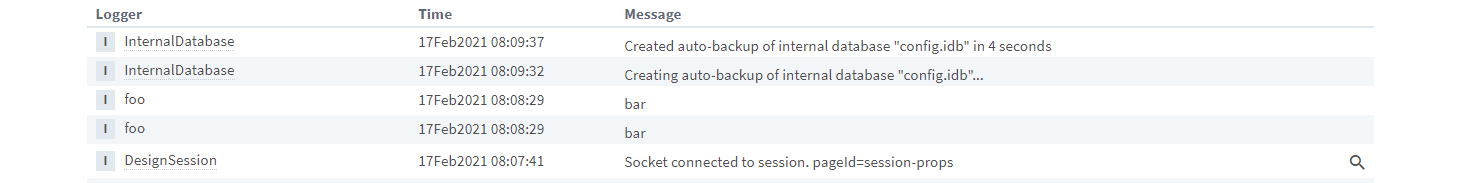

**Author:** ![pascal.fragnoud](https://sea1.discourse-cdn.com/inductiveautomation/user_avatar/forum.inductiveautomation.com/pascal.fragnoud/32/24728_2.png) [@pascal.fragnoud](https://forum.inductiveautomation.com/u/pascal.fragnoud)\
**Post date:** [February 17, 2021, 9:58am UTC](https://forum.inductiveautomation.com/t/creating-a-log-and-print-function-that-is-not-working/42203/7 "2021-02-17T09:58:23Z")
Then shouldn’t gateway event scripts logs be available in the gateway logs ?
I can’t figure out how to log anything !
I put a simple
```auto
logger = system.util.getLogger("foo")
logger.info("bar")
In a gateway tag change script doesn’t seem to log anything, or at least I can’t seem to be able to find it… This makes debugging quite a difficult task. Any pointer ?
**Author:** ![bschroeder](https://sea1.discourse-cdn.com/inductiveautomation/user_avatar/forum.inductiveautomation.com/bschroeder/32/13260_2.png) [@bschroeder](https://forum.inductiveautomation.com/u/bschroeder)\
**Post date:** [February 17, 2021, 1:11pm UTC](https://forum.inductiveautomation.com/t/creating-a-log-and-print-function-that-is-not-working/42203/8 "2021-02-17T13:11:20Z")
So first things first.
What version of Ignition?
Can you post your entire script you are using and tag setup for this event script? I just tested it on my development system on 8.1.1:
Tag Change Event
 ![image](https://us1.discourse-cdn.com/inductiveautomation/original/3X/6/d/6d78b77100d58dbeeb474b3e26e4b14d61905b54.png)
The resulting logger from the gateway page:
 ![image](https://us1.discourse-cdn.com/inductiveautomation/original/3X/b/4/b4f772903d00140ad3359f305182f32df8eafe33.png)
