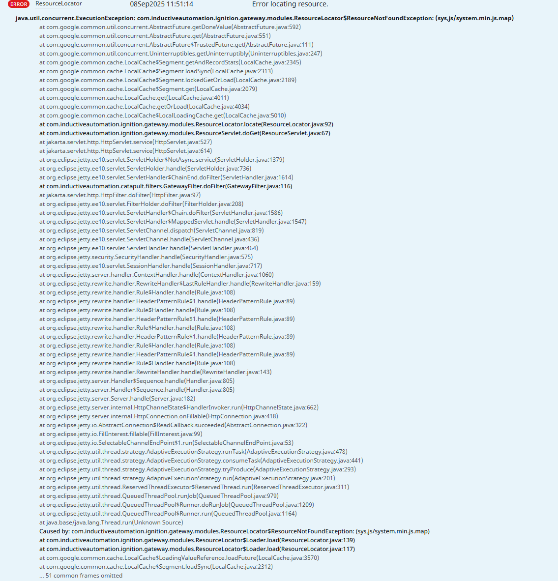

**Author:** ![Eden.Mar](https://avatars.discourse-cdn.com/v4/letter/e/35a633/32.png) [@Eden.Mar](https://forum.inductiveautomation.com/u/Eden.Mar)\
**Post date:** [September 8, 2025, 6:04pm UTC](https://forum.inductiveautomation.com/t/creating-custom-link-and-react-page-for-deviceextensionpoint/110395/7 "2025-09-08T18:04:58Z")
I don’t see it, whether I just land on the Device Connections page or when I click on my custom link. I did completely miss this error though:
 ![image](https://us1.discourse-cdn.com/inductiveautomation/original/3X/0/f/0f1a6f06169a0416460d8e39bb12e19fda590dd4.png)
**Post date:** [September 12, 2025, 3:52pm UTC](https://forum.inductiveautomation.com/t/creating-custom-link-and-react-page-for-deviceextensionpoint/110395/8 "2025-09-12T15:52:03Z")
I think I resolved it. For anyone following along or interested, I had a couple of mistakes that compounded each other. My original code example of
```python
public List<MenuAction> getMenuActions() {
    return List.of(new MenuAction("title", "descr", new ReactComponentInfo("DeviceConfiguration", new SystemJsModule(Util.MODULE_ID, "/res/web-ui-test/helloIgnition.js"))));
was incorrect. Because I was reusing the Ignition SDK example, the code should have looked like this:
```python
    return List.of(new MenuAction("title", "descr", new ReactComponentInfo("HelloIgnition", new SystemJsModule(Util.MODULE_ID, "/res/web-ui-test/helloIgnition.js"))));
The component ID matters here. I’m not sure if that is based on a field name in the web-ui folder or the name of the folder holding the .ts files, but I’ll figure that out later.
The other thing I got wrong was I had adjusted the web-ui/webpack.config.js file. That shouldn’t be necessary. When you open up the web-ui portion of a module, the internal folder structure is something like
> /mounted/path/to/helloIgnition.js
To get to that organization, SystemJsModule is created like:
> SystemJsModule jsModule = new SystemJsModule(MODULE\_ID, "/res/test/path/to/helloIgnition.js");
and the following methods need to be implemented:
```python
@Override
public Optional<String> getMountedResourceFolder() {
    return Optional.of("mounted");
@Override
public Optional<String> getMountPathAlias() {
    return Optional.of("test");
Where “test” would be a simple name for your module. The folder structure in the web-ui jar follows what is referenced in the jsModule creation, except for /res/test.
