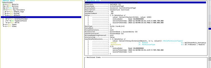

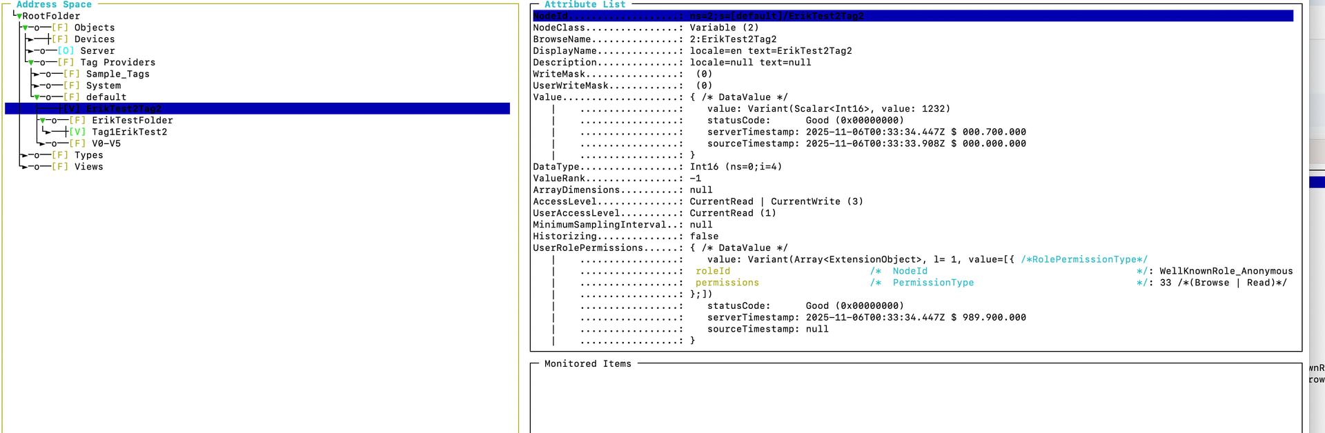

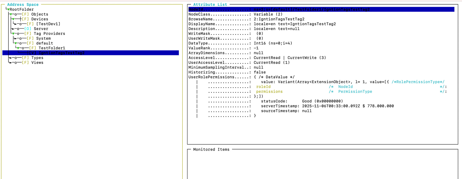

**Author:** ![epaulson](https://sea1.discourse-cdn.com/inductiveautomation/user_avatar/forum.inductiveautomation.com/epaulson/32/80779_2.png) [@epaulson](https://forum.inductiveautomation.com/u/epaulson)\
**Post date:** [November 6, 2025, 1:45am UTC](https://forum.inductiveautomation.com/t/creating-tag-groups-with-the-openapi-endpoints-in-the-gateway/111633/10 "2025-11-06T01:45:32Z")
> [@paul-griffith](#):
> In a word, yes, you absolutely can (and likely _should_) "layer" configuration from different layers into your deployed setups using deployment modes. Taking advantage of `external` vs `core` (vs `dev/test/prod`/whatever else you want) is a huge part of the advantage of 8.3 that, because it's so bleeding edge, there's a lot less guidance about.
I’ve been going down this route and have been having good luck, but I’m stuck on creating tags via the filesystem - I think I’m missing a file or a permission somewhere, but I’m not sure. I have a working Ignition setup with the Docker image, bind-mounting external/ into the container and have adjusted the server-config and created a Modbus device by editing files there, and that’s working OK.
I have a Modbus process that Ignition is able to read from - I can directly address it via the built-in OPC-UA server with a little util using the node-opcua toolkit, this works and I see my holding register value change:
`node object-examine.js "ns=1;s=[TestDev1]HR18"`
(the modbus “server” a slightly hacked up version of server\_updating.py from pymodbus, it has 6 holding registers that I update a value in every 2 seconds so it’s easy to see if something’s changing)
I have "exposedTagsEnabled": true in my server-config/config.json - the external directory is bind-mounted into the Ignition gateway container like so with docker-compose:
`volumes:`
` - ./volumes/gw-external:/usr/local/bin/ignition/data/config/resources/external`
I started with a VM with Ignition installed without Docker, so a regular install and the Modbus device added through the gateway’s web interface, the server configured through the web interface, and tags created with Designer. I tried to copy the files from tag-definition/ over the working setup to another VM that I am configuring entirely through the filesystem, and it doesn’t come out quite the same. Here’s what my files look like inside my container:

But I am having no luck with getting these exported with updating values - I should see something like this, which is from my configured-with-the-web-interface VM:
 ![Screenshot 2025-11-05 at 6.49.39 PM](https://us1.discourse-cdn.com/inductiveautomation/original/3X/e/b/eb2ef9929301f127e94139dff4d4d795e0505022.jpeg)
But what I get on my setup where I created the tags via the filesystem I am missing the first tag entirely, and the second tag (in the folder) does show up but the OPCUA variable object has no Value property:
 ![Screenshot 2025-11-05 at 7.20.16 PM](https://us1.discourse-cdn.com/inductiveautomation/original/3X/0/4/04b2605f6428d62fa6a99bf72252ef771f45d9ae.jpeg)
So I’m just not quite sure what to try - I suspect I’m missing something simple, like I need to copy another few files over, like maybe the tag-provider tree (I’m assuming - but maybe I’m wrong - that if I don’t have tag provider definitions in overlaid in external/ then the gateway just uses what it has in core/ ). I’ve tried different OPC paths -one with the ns=1;s= prefix stuff and one without, and that doesn’t seem to matter on either my working setup or my not-working setup. Or maybe there’s a permission I clicked on when setting up the VM with the web interface that I’ve missed copying over to the external/ tree on my Docker test, but I’ve been scouring all of the settings and I just don’t see anything.
I think I am close, the file system feels like exactly what I wanted to do, and the IA team did a nice job with the Docker image and documentation!
