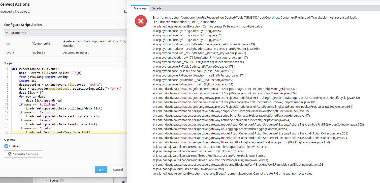

error is
```auto
om.inductiveautomation.ignition.common.script.JythonExecException
Traceback (most recent call last):
  File "<function:runAction>", line 12, in runAction
java.lang.IllegalArgumentException: Cannot create PyString with non-byte value
java.lang.IllegalArgumentException: java.lang.IllegalArgumentException: Cannot create PyString with non-byte value
	caused by org.python.core.PyException
	caused by IllegalArgumentException: Cannot create PyString with non-byte value
Ignition v8.1.33 (b2023101913)
Java: Azul Systems, Inc. 17.0.8
Error running action 'component.onFileReceived' on Docked/Tools TGMS@D/root/CoordinateContainer/FileUpload: Traceback (most recent call last): File "function:runAction", line 12, in runAction java.lang.IllegalArgumentException: Cannot create PyString with non-byte value at org.python.core.PyString.(PyString.java:57) at org.python.core.PyString.(PyString.java:70) at org.python.core.PyString.(PyString.java:74) at org.python.modules.\_csv.PyReader.parse\_save\_field(PyReader.java:249) at org.python.modules.\_csv.PyReader.parse\_process\_char(PyReader.java:165) at org.python.modules.\_csv.PyReader. **iternext** (PyReader.java:92) at org.python.pycode._pyx1712.runAction$1(function:runAction:21) at org.python.pycode.pyx1712.call\_function(function:runAction) at org.python.core.PyTableCode.call(PyTableCode.java:173) at org.python.core.PyBaseCode.call(PyBaseCode.java:306) at org.python.core.PyFunction.function\_\_\_call_(PyFunction.java:474) at org.python.core.PyFunction. **call** (PyFunction.java:469) at org.python.core.PyFunction. **call** (PyFunction.java:464) at com.inductiveautomation.ignition.common.script.ScriptManager.runFunction(ScriptManager.java:847) at com.inductiveautomation.ignition.common.script.ScriptManager.runFunction(ScriptManager.java:829) at com.inductiveautomation.ignition.gateway.project.ProjectScriptLifecycle$TrackingProjectScriptManager.runFunction(ProjectScriptLifecycle.java:852) at com.inductiveautomation.ignition.common.script.ScriptManager$ScriptFunctionImpl.invoke(ScriptManager.java:1010) at com.inductiveautomation.ignition.gateway.project.ProjectScriptLifecycle$AutoRecompilingScriptFunction.invoke(ProjectScriptLifecycle.java:934) at com.inductiveautomation.perspective.gateway.script.ScriptFunctionHelper.invoke(ScriptFunctionHelper.java:158) at com.inductiveautomation.perspective.gateway.script.ScriptFunctionHelper.invoke(ScriptFunctionHelper.java:97) at com.inductiveautomation.perspective.gateway.action.ScriptAction.runAction(ScriptAction.java:74) at com.inductiveautomation.perspective.gateway.model.ActionCollection$ActionSequence$ExecuteActionsTask.lambda$call$0(ActionCollection.java:263) at com.inductiveautomation.perspective.gateway.api.LoggingContext.mdc(LoggingContext.java:54) at com.inductiveautomation.perspective.gateway.model.ActionCollection$ActionSequence$ExecuteActionsTask.call(ActionCollection.java:252) at com.inductiveautomation.perspective.gateway.model.ActionCollection$ActionSequence$ExecuteActionsTask.call(ActionCollection.java:221) at com.inductiveautomation.perspective.gateway.threading.BlockingTaskQueue$TaskWrapper.run(BlockingTaskQueue.java:154) at java.base/java.util.concurrent.Executors$RunnableAdapter.call(Unknown Source) at java.base/java.util.concurrent.FutureTask.run(Unknown Source) at java.base/java.util.concurrent.ThreadPoolExecutor.runWorker(Unknown Source) at java.base/java.util.concurrent.ThreadPoolExecutor$Worker.run(Unknown Source) at com.inductiveautomation.perspective.gateway.threading.BlockingWork$BlockingWorkRunnable.run(BlockingWork.java:58) at java.base/java.lang.Thread.run(Unknown Source) java.lang.IllegalArgumentException: java.lang.IllegalArgumentException: Cannot create PyString with non-byte value

> [@rfolkes](#):
> `for row in data:`
is where it is pointing for the error.
**Post date:** [December 11, 2023, 11:11pm UTC](https://forum.inductiveautomation.com/t/csv-import-cannot-create-pystring-with-non-byte-value/83011/3 "2023-12-11T23:11:11Z")
> [@rfolkes](#):
The error's in the Jython stdlib CSV module.

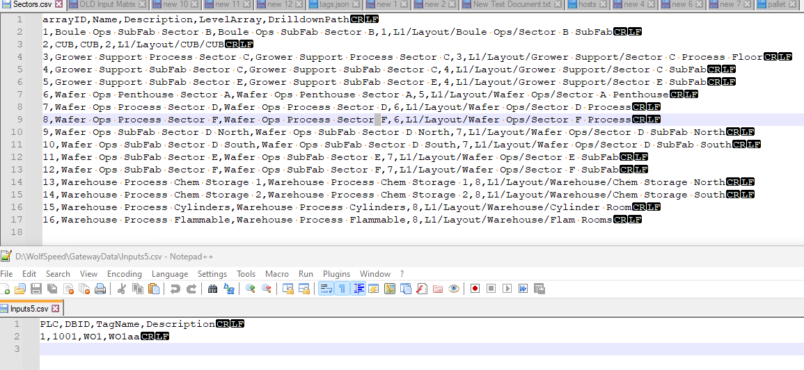

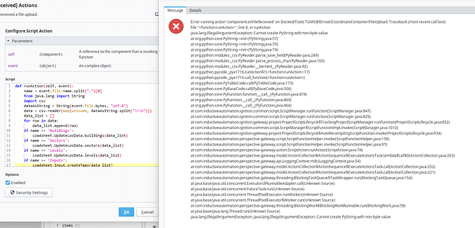

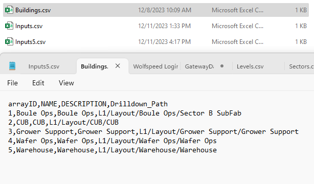

appears to be same result.
Odd thing to me is that it seems to work with one file and not another and I can't seem to find anything materially different.
Top one works... bottom does not
 ![image](https://us1.discourse-cdn.com/inductiveautomation/original/3X/d/6/d6b4a530576f2606fd5d2c9a55109754431c1d5f.png)
 ![image](https://us1.discourse-cdn.com/inductiveautomation/original/3X/8/8/8879c4ed159ea5701a0a38f2b7cb5f07db4ea56e.png)
if there is another way to convert csv file to list of list in python that would work as well, just this is the method I found.

**Post date:** [December 12, 2023, 3:15pm UTC](https://forum.inductiveautomation.com/t/csv-import-cannot-create-pystring-with-non-byte-value/83011/7 "2023-12-12T15:15:20Z")
Inputs5.csv has a BOM on it. Try using the `utf-8-sig` codec.

Three of the files are processed with `Loadsheet.UpdateLocData.<filename>` while Inputs.csv is processed with `Loadsheet.Input.createTags`. Is it `createTags` that's causing the problem?
@JordanCClark is probably correct. If you check the encoding menu in Notepad++ for each file you can see the difference in encoding (but not in the content!).

> [@JordanCClark](#):
ok looked that up and saved it as UTF-8 without the BOM and that worked. Now to figure out how it got there since I created the files the same way.
