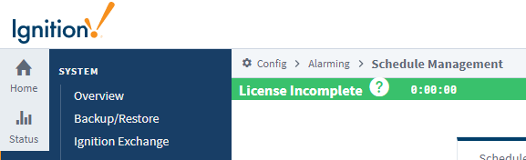

I am talking about the alarm schedules setup in the gateway. I would like to grab the start date and time of that schedule to use in another script.

There isn’t currently an easy way to get this. system.user.getSchedule() gives you an AbstractScheduleModel, which currently could be an instance of a BasicSchedule or a CompositeSchedule. Once you drill down to the component BasicSchedules, the information you can get is like what you see in the screen where you set it up – a string for the time on Monday, Tuesday, etc. You would need to do the parsing from there.
