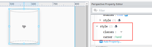

I have just noticed that a cursor configuration I created only works in the designer, and not when running the perspective view from the browser.
To test this, I created a test view using a cylindrical tank as the only object, and set the cursor to be “hand” when the mouse pointer floats over it:
 ![Tank_Configuration](https://us1.discourse-cdn.com/inductiveautomation/original/3X/6/5/65c51f61d2856cce8307aad74837f8f6bfa42f60.png)

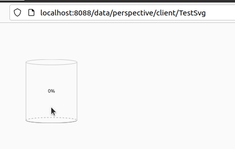

But when I ran the session, the cursor remained as the standard mouse pointer:
![Tank_InBrowser](https://us1.discourse-cdn.com/inductiveautomation/original/3X/6/f/6fcd2ee94d4d5225711e3c0a233245dfff97cddc.png)
I have saved the project multiple times (just to be sure everything was committed), so is this a bug? Or am I missing something?

Not sure what browser you are using.
But according to [CSS cursor property](https://www.w3schools.com/cssref/pr_class_cursor.asp) `hand` is not a valid css cursor property. The closest they list is `grab` or `grabbing`. I would attempt to use one of those and retry.

Yep, the issue was the name of the cursor I wanted to use. In looking through the accepted styles I actually want “pointer”.
@paul-griffith I blame you! In the solution to another one of my [questions](https://forum.inductiveautomation.com/t/programmatically-change-mouse-cursor/58314) you put the word “hand” into my head. And when I tried it in the designer it actually worked!
It seems that in the designer there is some alias from “hand” to “pointer” that doesn’t exist in the browser that I am using.
