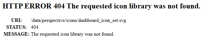

**Post date:** [October 22, 2025, 3:13pm UTC](https://forum.inductiveautomation.com/t/custom-icon-library-in-8-3/109259/10 "2025-10-22T15:13:08Z")
Was this updated in the 8.3.1 release?
Your fix worked perfectly for me in the 8.3.0 release, but on a fresh Gateway (running 8.3.1) using the same setup methodology (and using the same SVG sprite sheet), I am getting the following error.
### Error
Failed to load resource: the server responded with a status of 404 (Not Found)
![Screenshot of Chrome Dev Tools Console](https://us1.discourse-cdn.com/inductiveautomation/original/3X/5/0/507769f8f6f5e0cb68a1c3e0dee1ac7bf2f488d3.png)
My `config.json` and `resource.json` files are identical to yours (I even used the same `icons.svg` file name). If I follow the link at the end of the _Dev Tools Console Error_ I am greeted with the following page:
 ![Screenshot of link followed from error present in Chrome Dev Tools Console](https://us1.discourse-cdn.com/inductiveautomation/original/3X/5/2/52d3d56a42ca93dfcfa42e3b56ef5b3a78c312b8.png)
_Note_: I have been send POST requests to `/data/api/v1/scan/config` to pick the update (I have also tried restarting the Gateway several times.
### Files
I can send the SVG if required but as I say, the same file was used on a different gateway with no problems. So I didn’t bother copying it over.
- Result of running the `ls` command on the directory in which my `dashboard_icon_set` resource is located.
![Result of 'ls' command run in the directory of my icon resource](https://us1.discourse-cdn.com/inductiveautomation/original/3X/e/8/e88b921bf0d60556dac9134a20c9190c18a23a52.png)
- My `config.json` file:
```python
 "svgFileName": "icons.svg"
- My `resource.json` file:
```python
    "scope": "A",
    "version": 1,
    "restricted": false,
    "overridable": true,
    "files": [
        "config.json",
        "icons.svg"
    "attributes": {
Any solutions would be appreciated, I very well may have made a silly mistake somewhere when copying my resource from one Gateway to another but I can’t figure out what’s going on. Any ideas?
**Post date:** [October 22, 2025, 3:57pm UTC](https://forum.inductiveautomation.com/t/custom-icon-library-in-8-3/109259/11 "2025-10-22T15:57:00Z")
Nothing should have changed. Are there any errors in your gateway logs from the asset manager?
**Author:** ![MG3](https://sea1.discourse-cdn.com/inductiveautomation/user_avatar/forum.inductiveautomation.com/mg3/32/84125_2.png) [@MG3](https://forum.inductiveautomation.com/u/MG3)\
**Post date:** [October 22, 2025, 4:44pm UTC](https://forum.inductiveautomation.com/t/custom-icon-library-in-8-3/109259/12 "2025-10-22T16:44:49Z")
I am so sorry! I completely forgot to check the logs (didn’t even realise an error like this would get logged). There was a small error in my SVG. I assume I must have accidentally introduced it when copying the file over somehow.
Thanks for your help!

Good morning everyone,
I’m also trying to add some icons to version 8.3.6. For example, I’m using the Bootstrap set downloaded from the Exchange (which I currently use in 8.1.47), but I can’t get them to show up in the Designer.
What am I doing wrong?
 ![image](https://us1.discourse-cdn.com/inductiveautomation/original/3X/d/a/da28bbf28a38185c8925d06b67cc69b2680d2790.png)
Thanks for the support.
**Author:** ![aaronrai24](https://sea1.discourse-cdn.com/inductiveautomation/user_avatar/forum.inductiveautomation.com/aaronrai24/32/87248_2.png) [@aaronrai24](https://forum.inductiveautomation.com/u/aaronrai24)\
**Post date:** [April 30, 2026, 3:05pm UTC](https://forum.inductiveautomation.com/t/custom-icon-library-in-8-3/109259/19 "2026-04-30T15:05:18Z")
![image](https://us1.discourse-cdn.com/inductiveautomation/optimized/3X/5/d/5d7930ca49ffd9851bae60ad1a933ed701d1694a_2_690x31.png)
is bootstrap-icons actually a `.svg` file? After that use the **Scan File System** button found on the top right of the Gateway's Platform Overview page to pull in your file changes.
**Author:** ![Aiasa21](https://avatars.discourse-cdn.com/v4/letter/a/aeb1de/32.png) [@Aiasa21](https://forum.inductiveautomation.com/u/Aiasa21)\
**Post date:** [April 30, 2026, 3:48pm UTC](https://forum.inductiveautomation.com/t/custom-icon-library-in-8-3/109259/20 "2026-04-30T15:48:39Z")
Thanks for your help, it works perfectly. After clicking the **Scan File System** button now I can see the bootstrap icons.
Just a note: if you migrate a project, the folder containing the .svg and .json files must have the same name of the library, otherwise, the icon paths in the designer will be incorrect.
