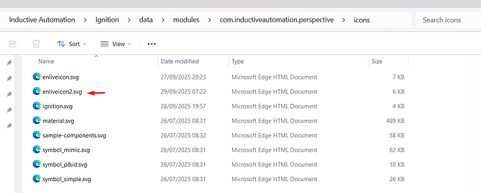

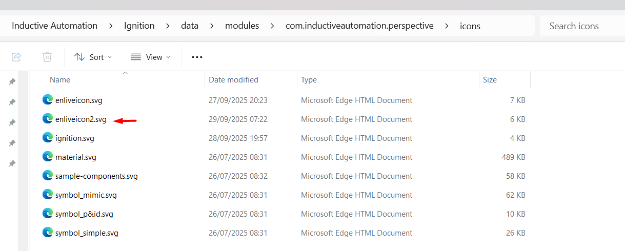

Hi everyone,
I’ve created a custom icon library and placed it in the advised path according to the Ignition documentation. However, the icon library is not appearing, even after restarting both the gateway and the designer.
Am I missing a step in the setup? Any guidance would be greatly appreciated.
Thanks in advance!
[https://docs.inductiveautomation.com/docs/8.1/ignition-modules/perspective/working-with-perspective-components/images-and-icons-in-perspective#use-a-custom-icon-repository](https://docs.inductiveautomation.com/docs/8.1/ignition-modules/perspective/working-with-perspective-components/images-and-icons-in-perspective#use-a-custom-icon-repository)
 ![image](https://us1.discourse-cdn.com/inductiveautomation/original/3X/0/e/0edb8a71e460b7cef622aaaf1c7de298394cf4b8.png)
 ![image](https://us1.discourse-cdn.com/inductiveautomation/original/3X/c/1/c1437d640662a03a9524f57e8a0624de4513461c.png)

**Author:** ![TechEnlive](https://avatars.discourse-cdn.com/v4/letter/t/3be4f8/32.png) [@TechEnlive](https://forum.inductiveautomation.com/u/TechEnlive)\
**Post date:** [September 29, 2025, 2:02pm UTC](https://forum.inductiveautomation.com/t/custom-icons-in-material-svg-disappear-after-server-restart/110969/9 "2025-09-29T14:02:06Z")
Hi all,
First, thank you everyone for your help! I was able to resolve the issue using the **Perspective Icon Manager**.
This tool is very helpful—it not only resolved the current problem but also immediately highlights any issues when adding new icons.
@paul-griffith I could not find any icon library–related errors in the gateway log.
[Perspective Icon Manager](https://inductiveautomation.com/exchange/2577/overview)
I even restart the gateway multiple times to confirm that it successfully loads our custom library.
 ![image](https://us1.discourse-cdn.com/inductiveautomation/original/3X/c/e/cefd431bde929bc0e6eefe465203ebef90c88cc8.png)
Thanks.
