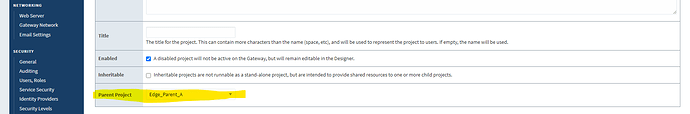

Hi all, i am using v8.1.7
I realised when i select multiple components and tried to do some security settings, instead of the common tick and untick options, there is a ‘-’ option.
Tried to search around in the manual, but couldn’t find the meaning of it, could someone help to explain what is the difference between tick and - icon?
 ![image](https://us1.discourse-cdn.com/inductiveautomation/original/3X/5/0/5018c50071a40e0ebf5769fe0a6481b315800841.png)

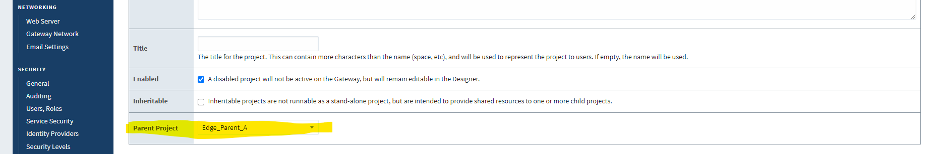

**Author:** ![craigb](https://avatars.discourse-cdn.com/v4/letter/c/9f8e36/32.png) [@craigb](https://forum.inductiveautomation.com/u/craigb)\
**Post date:** [July 20, 2022, 2:10pm UTC](https://forum.inductiveautomation.com/t/dash-icon-for-multiple-selection-in-security-settings/62109/2 "2022-07-20T14:10:12Z")
Does the project have a parent project as it looks like the options with the - are being passed down from the parent project (Inherit Permissions)
 ![image](https://us1.discourse-cdn.com/inductiveautomation/original/3X/6/7/6775ec2137b06666916dd26b1b31fadacb564695.png)
**Post date:** [July 20, 2022, 7:28pm UTC](https://forum.inductiveautomation.com/t/dash-icon-for-multiple-selection-in-security-settings/62109/3 "2022-07-20T19:28:15Z")
Inherit Permissions, tells the component to Inherit it’s permissions from it’s parent container.
So for instance if you group multiple components together then you can set permissions on the group, and then chose to have the child components inherit those permissions (or not) as well. This include if the component should Inherit Permissions.
The Check Mark means that the selected (component) will have the restriction, the `-` means that the selected component will Inherit from it’s parent.

**Author:** ![yin.cheng](https://avatars.discourse-cdn.com/v4/letter/y/85f322/32.png) [@yin.cheng](https://forum.inductiveautomation.com/u/yin.cheng)\
**Post date:** [July 21, 2022, 1:26am UTC](https://forum.inductiveautomation.com/t/dash-icon-for-multiple-selection-in-security-settings/62109/4 "2022-07-21T01:26:03Z")
Hi Craigb, nope i do not have any Parent Project for this project.
