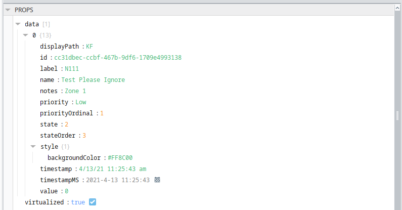

I want a table to colour rows based on the priority and acknowledgement status of the alarm. I’m unable to use an Alarm Status Table because I want to set the headings.
I have implemented a Table with a script to populate data. The script gives each row a background colour. Data populates successfully, and an example is below.
 ![Untitled](https://us1.discourse-cdn.com/inductiveautomation/original/3X/0/1/0186ccb127dc85f98b43dcc6ac0761c5a8db08cf.png)
However, the rows don’t change colour. I’m unable to find that colour listed anywhere in my external debugger. Why isn’t it coming through?
Thank you for your time.

Hi @james.beeley, the format of the data is slightly incorrect. You need to put all your values into a “value” object and then have a style object as it’s sibling. Something like this:
```auto
    "value": {
      "displayPath": "FK",
      "id": 1,
      "someCol": 3
    "style": {
      "backgroundColor": "#FF8000"
    "value": {
      "id": 2,
      "someCol": 5

I have almost the same table)) I mean I don’t use the Ignition Alarm Table.
So… this is how I append data to the Table (this is a part of my Script… this is for You to see how I did it):
```auto
data = []
data.append({"selected":{'value':False,'style':{'background':'#FFFFFF'}}, "Group":group, "style":style,"id":id_item, "displayPath": displayPath_item, "priority":priority_item, "priorityOrdinal":priorityOrdinal_item, "state":state_item, "stateOrder":stateOrder_item, "timestamp":timestamp_item, "timestampMS":timestampMS_item, "value":eventValue_item, "ack":ack_item})
Matthew is right)
