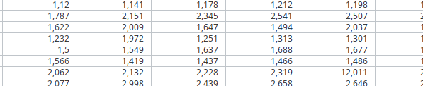

Hello Team,
I am facing issue in fetching the values from Oracle database.
Values are getting round off while integrating oracle database to ignition.
Value in Oracle database of sample column: 1.0008
Value in Ignition database of sample Column: 1.001
kindly help us to rectify this issue and please elaborate the root cause and related settings/configuration required.

How do you integrate Oracle Database to Ignition, through a named query? the round off happens before or after you put the data on a component?

Hi,
Thanks for response, oracle database is connected in gateway. In database connections through required drivers.
who’s URL description is like:
The format of the Oracle connect URL is:
`jdbc:oracle:thin:@host:port:SID`
With the three parameters (in bold)
- **host** : The host name or IP address of the database server.
- **port** : The port that the database server is running on. Oracle's default port is **1521**.
- **SID** : the system ID that identifies the database to connect to.
And it is rounding off after decimal value. the main data in database is up to 4 digit after decimal but in ignition when i am checking through database management tool. It is showing up to three decimal values only.

**Author:** ![Alejandro\_Alaco](https://sea1.discourse-cdn.com/inductiveautomation/user_avatar/forum.inductiveautomation.com/alejandro_alaco/32/59849_2.png) [@Alejandro\_Alaco](https://forum.inductiveautomation.com/u/Alejandro_Alaco)\
**Post date:** [September 8, 2025, 11:44am UTC](https://forum.inductiveautomation.com/t/data-getting-round-off-in-ignition-while-connecting-to-oracle-database/110439/5 "2025-09-08T11:44:29Z")
This happen to me also and is fine on my case , but I´m not sure how could you fix it.
 ![image](https://us1.discourse-cdn.com/inductiveautomation/original/3X/a/e/aecf191bc11117205ac2a52b24814047cc9e0949.png)
a workaround would be pass the values 1,2437 to 12,437 on a new oracle table, call that table from Ignition and then restore the value to 1,2437. I can´t think of other solution now.
**Post date:** [September 8, 2025, 12:02pm UTC](https://forum.inductiveautomation.com/t/data-getting-round-off-in-ignition-while-connecting-to-oracle-database/110439/6 "2025-09-08T12:02:31Z")
The default number format is to three digits. Add column data to your table and adjust the number format.
