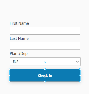

Hi, I am fairly new to ignition and perspective, so I don’t know if this is a database setup issue or some simple thing I wasn’t aware of:
I am trying to have a simple check in “app” using perspective web browser capabilities. The idea is guests scan a QR code that takes them to the perspective page URL where they input the following:
 ![image](https://us1.discourse-cdn.com/inductiveautomation/original/3X/5/1/51ce00df4a45b8cd17bef47422c3da4a40cbce81.png)
I have this script right now onAction for my button that references the following named query:
```python
def runAction(self, event):
    first = self.getSibling("TextField").props.text
    last = self.getSibling("TextField_0").props.text
    dep = self.getSibling("Dropdown").props.value
    system.db.runNamedQuery("insertCheckin", {
        "first_name": first,
        "last_name": last,
        "department": dep
```python
INSERT INTO event_checkins (first_name, last_name, department)
VALUES (:first_name, :last_name, :department)
This setup DOES work when I playtest it in the designer and watch it log into the db using the query browser tool. However when I open an instance in the web browser none of my inputs do anything. The database never gets updated unless I do it locally in the designer.
I don’t know if there are security settings or anything like that so any help identifying this issue would be appreciated.

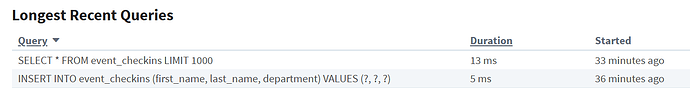

Is this what you mean? I’ll be honest I didn’t know you could look at db logs in the gateway.
 ![image](https://us1.discourse-cdn.com/inductiveautomation/original/3X/c/a/ca9c70af635745f4f14fbc0a9faee9b209465c88.png)
**Author:** ![David\_Stone](https://sea1.discourse-cdn.com/inductiveautomation/user_avatar/forum.inductiveautomation.com/david_stone/32/79749_2.png) [@David\_Stone](https://forum.inductiveautomation.com/u/David_Stone)\
**Post date:** [October 6, 2025, 8:13pm UTC](https://forum.inductiveautomation.com/t/database-not-updating-across-perspective-instances/111220/4 "2025-10-06T20:13:42Z")
While this DB log shows the query was actually sent, the gateway logs `> STATUS > LOGS` will normally have the errors that come back from the database if they occur.
