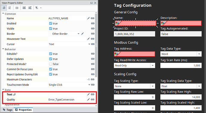

I am trying to display a string from a dataset in a text field in Ignition 8.0.12 Vision.
I am getting the string by referencing a specific column and row in the dataset:
```auto
{Root Container.tags}[7][0]
I am using the same method to get integers and booleans from the same dataset and those are working correctly in on screen objects such as numerical displays and dropdown lists but for whatever reason the strings from the dataset are causing the onscreen objects to display “Error\_TypeConversion”.
I did check the type using python:
```auto
ds = system.dataset.toPyDataSet(event.source.parent.tags)
system.gui.messageBox(str(type(ds[0][7])))
![2022-01-21 14_53_23-UnityVM - VMware Workstation](https://us1.discourse-cdn.com/inductiveautomation/original/3X/c/e/ce750bef392fd72bf369c7e4e2debfbbf4f41fe0.png)
From this it tells me that the contents for the dataset ‘cell’ is actually unicode and not a string. I suspect this has something to do with the issue but I am not sure quite how to handle it using Ignition’s expression language.
I am looking for a method to convert the unicode to a string with Expression so that it can be displayed on screen in a text field.

> [@paul-griffith](#):
> w is the `tags` property on the root container populated
Unless there is another place I can find a more descriptive error message all I am seeing on screen is this:
 ![2022-01-21 15_05_23-UnityVM - VMware Workstation](https://us1.discourse-cdn.com/inductiveautomation/original/3X/a/c/ac2047e9edb45585bbc388a4bacb561e1a073a3f.png)
Where the binding on the 'text' property of the text field is where the expression to extract the value is located.
 ![2022-01-21 15_12_50-UnityVM - VMware Workstation](https://us1.discourse-cdn.com/inductiveautomation/original/3X/4/2/424955d155517da3f3ccd9bb2549baf62f0379e3.png)

**Post date:** [January 21, 2022, 9:15pm UTC](https://forum.inductiveautomation.com/t/dataset-string-value-throws-error-typeconversion-in-text-field/55267/4 "2022-01-21T21:15:18Z")
I think your dataset subscript is malformed. I think it should be `{dataset}[row, col]` all inside the one set of square brackets: [Expression Language and Syntax - Ignition User Manual 8.1 - Ignition Documentation](https://docs.inductiveautomation.com/display/DOC81/Expression+Language+and+Syntax#ExpressionLanguageandSyntax-DatasetAccess)
Also, you can use a column name to make things a bit more explicit and maintainable in the future (if your JSON response ever ends up in a different order, it’ll be less fragile).
Some general troubleshooting things to try if that isn’t it:
1. Right click the component and ‘Run Diagnostics’ - that will confirm what properties are returning that error quality. A type coercion error is pretty unusual for a string typed property - basically everything in Java _can_ be coerced to some string representation via `Object.toString()`.
2. Wrap your expression in the `try` function and return some sentinel value to confirm it’s the actual source of the problem. I asked about the source of the value because in some scenarios, a binding will start up with a default (null) value for a custom property, _then_ evaluate your binding to deliver the real value - which can cause temporary errors during window startup, for instance.
**Author:** ![nellis1](https://avatars.discourse-cdn.com/v4/letter/n/0ea827/32.png) [@nellis1](https://forum.inductiveautomation.com/u/nellis1)\
**Post date:** [January 21, 2022, 9:30pm UTC](https://forum.inductiveautomation.com/t/dataset-string-value-throws-error-typeconversion-in-text-field/55267/5 "2022-01-21T21:30:40Z")
You are exactly right! the dataset subscript was incorrect. I was trying to use python syntax but of course that wasn’t working in the Expression Language.
