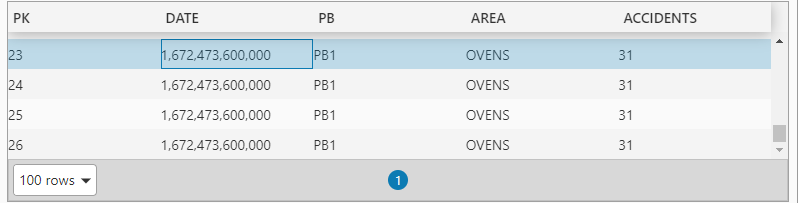

When I bind this named query to the data property of my table in perspective the date comes back as a very large number instead of something readable, in my database its a data type "date" and displays correctly.. any ideas?
**Post date:** [December 15, 2022, 5:13pm UTC](https://forum.inductiveautomation.com/t/date-being-returned-as-1-672-437-600-000-when-binding-named-query-to-table-in-perspective/67682/2 "2022-12-15T17:13:17Z")
That's an epoch milliseconds value. Do you have an entry in the `columns` array for your Date table, and what is it set to treat your column as?

**Post date:** [December 15, 2022, 5:26pm UTC](https://forum.inductiveautomation.com/t/date-being-returned-as-1-672-437-600-000-when-binding-named-query-to-table-in-perspective/67682/4 "2022-12-15T17:26:49Z")
In your perspective table component, find the `columns` property under `props`. Add entries to it for each column in your dataset (as needed). The first element in each column object should be a key `field` with a value that exactly matches the column name of your dataset.
Then, further down in the column object corresponding to your `DATE` field, change the 'render' property to 'date', and see if that fixes your issue.

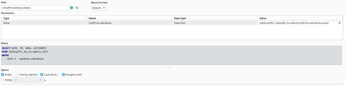

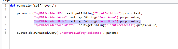

So while I've got you're attention...
I am trying to filter only on the date selected by this date input:
 ![image](https://us1.discourse-cdn.com/inductiveautomation/original/3X/4/c/4c479f715f3fca4e62e64ebffcee777eec4ca465.png)
this works for saving when I run my save named query but it does not seem to work when using that same value to filter:
 ![image](https://us1.discourse-cdn.com/inductiveautomation/original/3X/d/a/da49e30646c35b48ed6213d9f37e63fb4eac9da7.png)
**Post date:** [December 15, 2022, 5:47pm UTC](https://forum.inductiveautomation.com/t/date-being-returned-as-1-672-437-600-000-when-binding-named-query-to-table-in-perspective/67682/8 "2022-12-15T17:47:46Z")
"Does not work" as in returns no data? Or is there any kind of error?
If the former: Is the tag of the correct type? Does it work if you pass the parameter wrapped in the `toDate` expression function (as in, `toDate({path/to/tag})`)

**Author:** ![dkhayes117](https://sea1.discourse-cdn.com/inductiveautomation/user_avatar/forum.inductiveautomation.com/dkhayes117/32/68344_2.png) [@dkhayes117](https://forum.inductiveautomation.com/u/dkhayes117)\
**Post date:** [December 15, 2022, 6:02pm UTC](https://forum.inductiveautomation.com/t/date-being-returned-as-1-672-437-600-000-when-binding-named-query-to-table-in-perspective/67682/10 "2022-12-15T18:02:29Z")
Try changing your query where clause to this so it matches on just the date and not the date and time.
```auto
date(DATE) = date(:myPB1AccidentDate)

**Author:** ![Matthew.gaitan](https://avatars.discourse-cdn.com/v4/letter/m/59ef9b/32.png) [@Matthew.gaitan](https://forum.inductiveautomation.com/u/Matthew.gaitan)\
**Post date:** [December 15, 2022, 6:18pm UTC](https://forum.inductiveautomation.com/t/date-being-returned-as-1-672-437-600-000-when-binding-named-query-to-table-in-perspective/67682/13 "2022-12-15T18:18:38Z")
IIRC your WHERE clause should be something like so:
`WHERE CAST([Date] AS date) = CAST(:myPB1AccidentDate AS date)`
Also, wrap DATE in your SELECT with `[]`:
`SELECT [Date]`
actually you might not need to wrap it with `[]`. It worked in SSMS for me without wrapping it

**Author:** ![Christopher\_Jacobs](https://avatars.discourse-cdn.com/v4/letter/c/59ef9b/32.png) [@Christopher\_Jacobs](https://forum.inductiveautomation.com/u/Christopher_Jacobs)\
**Post date:** [December 15, 2022, 6:32pm UTC](https://forum.inductiveautomation.com/t/date-being-returned-as-1-672-437-600-000-when-binding-named-query-to-table-in-perspective/67682/18 "2022-12-15T18:32:28Z")
🥸 i may or may not have had a date selected with no entries...
