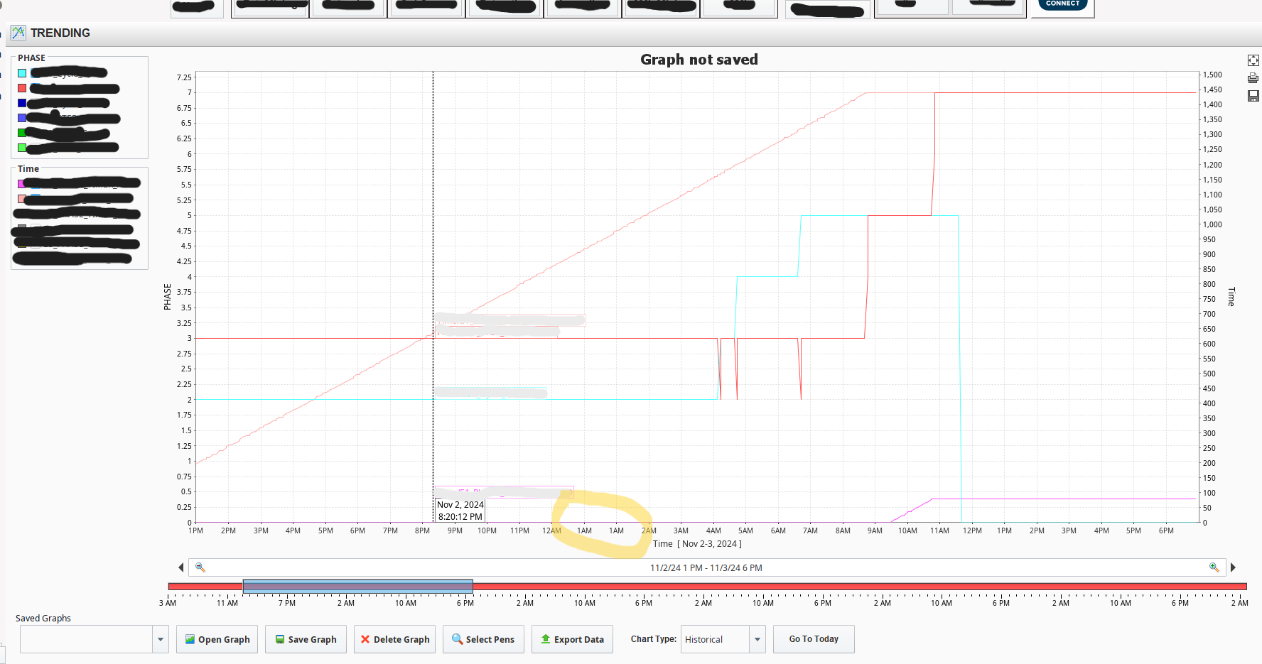

I noticed in the trend when I look at Sunday morning (we fall back an hour for dst), there are two 1am’s, is this a bug with the trend or the historian? Any work arounds as its throwing off the data analysis. thanks!
 ![daylight savings](https://us1.discourse-cdn.com/inductiveautomation/original/3X/5/3/53139d1356eef271b82c9641530b98f86ed4cd13.png)

Not a bug. When the clock falls back (forward is in the spring) at 2am, you repeat the 1am hour in the adjusted time zone. The chart is correct. If your analysis cannot handle the 25 hour day (or the 23 hour day in the spring), the **analysis** is broken.

The sql scripts work fine but every other person on the floor gets thrown off looking at the trend.

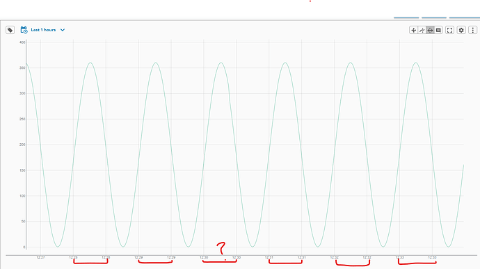

Also, they’ll love if you move to Perspective. Double times is a standard feature regardless of DST 🙄
