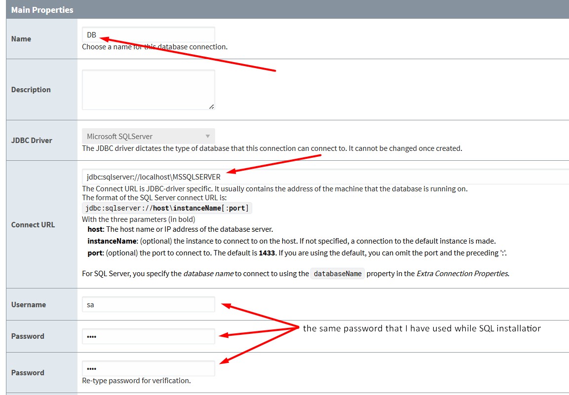

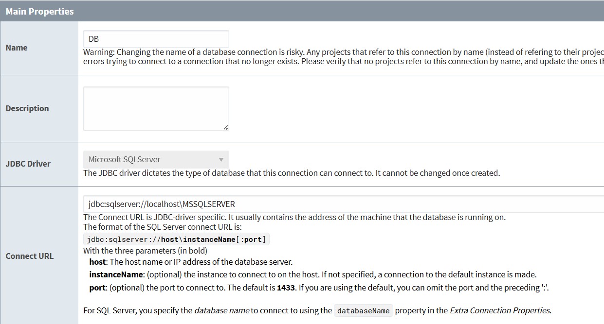

**Author:** ![mehdi.sajjadi](https://avatars.discourse-cdn.com/v4/letter/m/ed655f/32.png) [@mehdi.sajjadi](https://forum.inductiveautomation.com/u/mehdi.sajjadi)\
**Post date:** [December 8, 2025, 7:41am UTC](https://forum.inductiveautomation.com/t/db-connection-faulted/112672/3 "2025-12-08T07:41:51Z")
Thanks Peter
I have already watched the videos and followed them up, I have attached the steps that I have passed to create DB.
Step 1:
![1](https://us1.discourse-cdn.com/inductiveautomation/optimized/3X/f/5/f506413fc65526bd98fdafcb94612a842897c864_2_690x50.jpeg)
Step 2:
 ![2](https://us1.discourse-cdn.com/inductiveautomation/original/3X/9/6/96e04ba4f01349ac53d5d7e5d119f2baebe191ae.jpeg)
Step 3: Error message
 ![3](https://us1.discourse-cdn.com/inductiveautomation/original/3X/9/6/9683141d2c11299dda58a4ed039ce098b5e3d7ee.jpeg)
Any missing step. unfortunately I am not very familiar with SQL and haven no idea if the settings are correct.
Thanks and Regards
**Author:** ![Cose\_Peter1](https://sea1.discourse-cdn.com/inductiveautomation/user_avatar/forum.inductiveautomation.com/cose_peter1/32/79174_2.png) [@Cose\_Peter1](https://forum.inductiveautomation.com/u/Cose_Peter1)\
**Post date:** [December 8, 2025, 8:36am UTC](https://forum.inductiveautomation.com/t/db-connection-faulted/112672/4 "2025-12-08T08:36:49Z")
> [@mehdi.sajjadi](#):
This is not the error message. The error message is in the database connections section is **status** tab in the gateway.

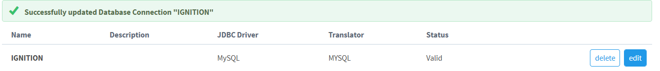

Sorry, wrong attachment.
 ![4](https://us1.discourse-cdn.com/inductiveautomation/original/3X/9/b/9b288565ea0692dd6bf0950a321c09a295082a7c.jpeg)
A quick note, that I have used the username : **sa** and password created at following page while adding SQL connection.

Verify if you have set the right server name in **connect URL** section.
Also check if you have set `databaseName=test` or to whatever DB name that you have created in **Extra Connection Properties**

This issue is normally because TCP/IP is not enabled on the MSSQL server.
See here: [Troubleshooting: Enabling TCP/IP in the SQL Server | DUG Insight User Manual | DUG Insight User Manual](https://help.dugeo.com/m/Insight/l/438913-troubleshooting-enabling-tcp-ip-in-the-sql-server)

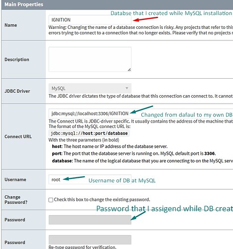

**Post date:** [December 9, 2025, 12:45am UTC](https://forum.inductiveautomation.com/t/db-connection-faulted/112672/9 "2025-12-09T00:45:48Z")
Thanks @Matrix_Engineering @Cose_Peter1 @jonathan.taylor for your advices.
I wasn’t successful on Microsoft SQL ,but could create DB using MySQL.
I am very novice at using SQL, so I needed to upgrade my knowledge about it.
By the way, I described steps, just in case if someone like me have issue of DB Creation.
1. Installed MySQL , I learned from this YouTube video : [MySQL installation](https://www.youtube.com/watch?v=k65ZdsCpI2E)
2. I have done following settings at ignition Gateway
3. Done!
 ![image](https://us1.discourse-cdn.com/inductiveautomation/original/3X/b/0/b0b5fcba5ae9e6ad7e15e040ae9f7dddefd26706.png)
Appreciate you kind support.
**Post date:** [December 9, 2025, 12:56pm UTC](https://forum.inductiveautomation.com/t/db-connection-faulted/112672/10 "2025-12-09T12:56:56Z")
I know you moved to mysql, but where did you get that instance name from (MSSQLSERVER)? My guess is that you created the instance as the default instance which means this should be blank on the ignition connection. Ie just
jdbc…./localhost/
