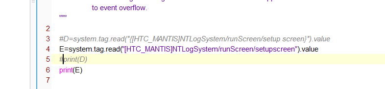

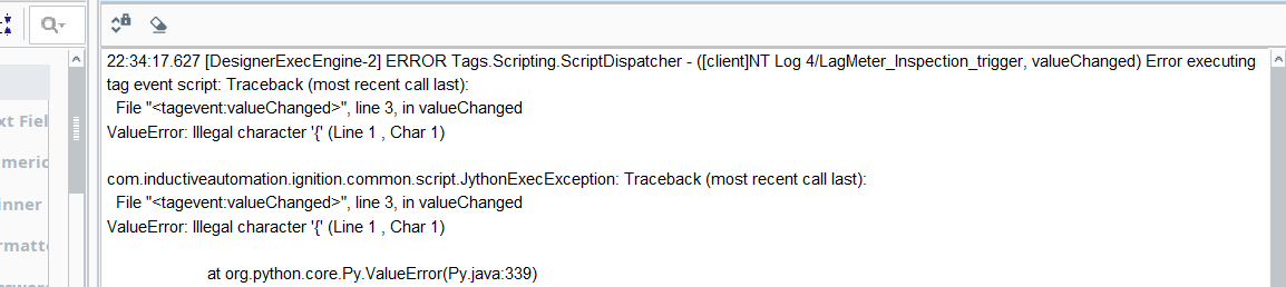

i have one project update from 7.9.10 to 8.0.8
i found some scripting in value change not work
finally i find the tag setup screen i have use the red line high light read have issue
 ![image](https://us1.discourse-cdn.com/inductiveautomation/original/2X/e/e93ed6e12c74d6fd2f65636d3b3ad7201455644f.png)
if this tag is setupscreen i use the blueline highlight
 ![image](https://us1.discourse-cdn.com/inductiveautomation/original/2X/9/9ad9dd4c9d1846bb15b8b871e993ae22c3f65c86.png)
if the value change it will be ok,
 ![image](https://us1.discourse-cdn.com/inductiveautomation/original/2X/5/5564127f8a869bf8ca74a4885948549c0909756e.png)
from my test the only difference if the tag have a blank space, it will fault, it no blank space it will work correctly.
i don’t know this is a bug or already solved by newer version.

On line 3, your tag path is enclosed with curly brackets { }.
Remove those and it should work.
**Author:** ![yifeiliu08](https://avatars.discourse-cdn.com/v4/letter/y/bbe5ce/32.png) [@yifeiliu08](https://forum.inductiveautomation.com/u/yifeiliu08)\
**Post date:** [March 13, 2020, 6:49am UTC](https://forum.inductiveautomation.com/t/def-valuechanged-issue-in-ignition-8-0-8/33045/3 "2020-03-13T06:49:22Z")
thanks, it works
