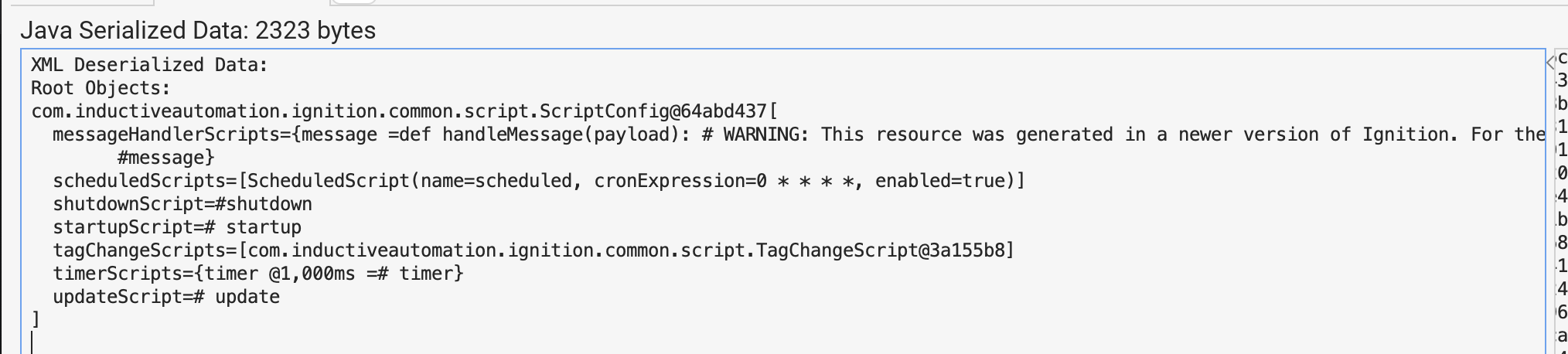

**Post date:** [September 26, 2025, 11:39pm UTC](https://forum.inductiveautomation.com/t/deserializing-event-scripts-with-kindling/110978/5 "2025-09-26T23:39:12Z")
Feel free to try this PR out:
> <https://github.com/inductiveautomation/kindling/pull/317>
> Fixes #312
It's probably not immediately useful to you, but should prove the concept:
 ![image](https://us1.discourse-cdn.com/inductiveautomation/original/3X/9/f/9f11f5fa7b1f85224104c495b687613a59cf11f3.png)
