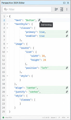

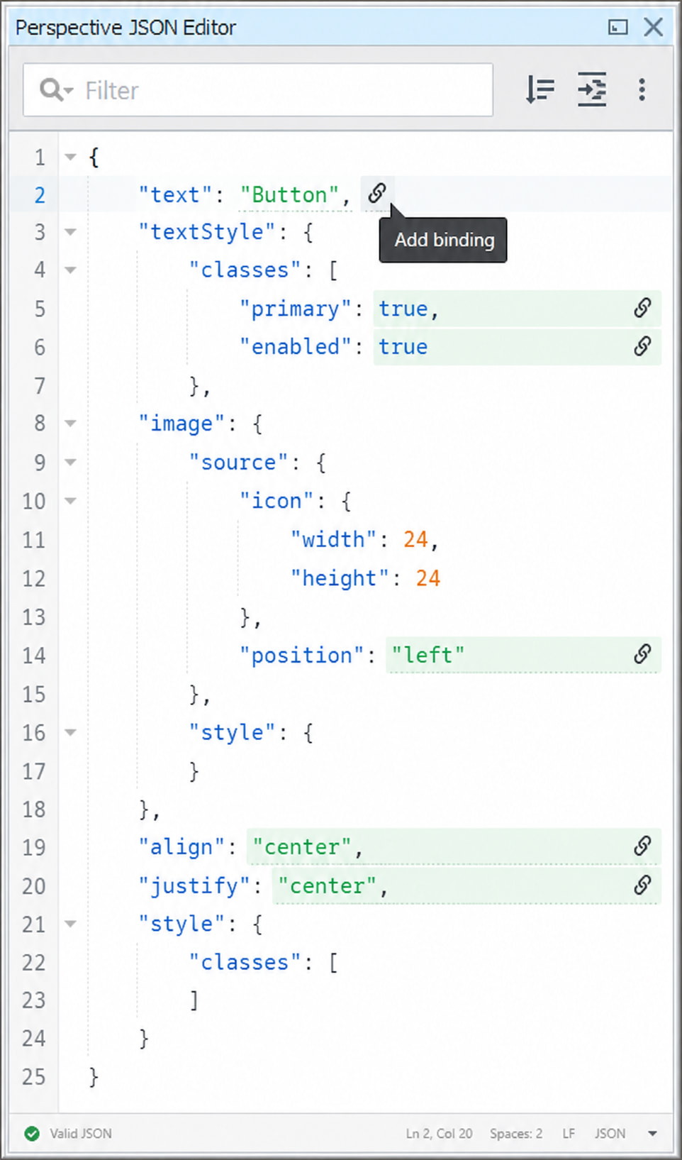

If we're throwing stuff out here....
I've thought about building a new Perspective property editor using a `RSyntaxTextArea`.
I really hate the amount of mouse movements required when setting up Perspective components.
Instead of needing the use the UI for adding and changing properties:
 ![image](https://us1.discourse-cdn.com/inductiveautomation/original/3X/8/9/89f8a37ec722b14d5ac84fc0040ab32917b964b3.png)
You would have a JSON text editor that allows you to bind parts of the tree:
(Clanker generated image)
 ![image](https://us1.discourse-cdn.com/inductiveautomation/original/3X/4/e/4e1ebf165d6e8068d98dfd78c9546184c4e2885a.jpeg)
1. Faster to type object structures.
2. Enhanced view of which parts of the tree are populated by bindings.
3. Easier to copy/paste parts of the tree.
4. More text = more LLM friendly (kinda the same as #3).

I always thought a fuzzy search tool would be nice in the opc tag browser window. The default size of this window is too small.
 ![image](https://us1.discourse-cdn.com/inductiveautomation/original/3X/1/b/1b35c178aa8be9ad880bdd6c18e70abe13b44aa1.png)
**Post date:** [July 1, 2026, 12:46pm UTC](https://forum.inductiveautomation.com/t/designer-quality-of-life-mods/116195/20 "2026-07-01T12:46:38Z")
> [@smcfarlane](#):
I think the issue with this one would be that, at least in the past, I've found browsing the opc server to be incredibly slow when you try to browse for everything, which is what you would need to do in order to do any type of filtering. Unless there's something I'm missing... @Kevin.Herron perhaps might have something to offer here?
