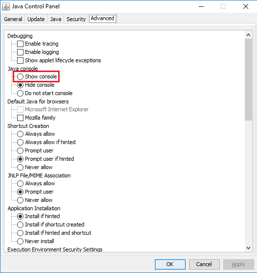

Hello, for some reason designer isn’t launching on my laptop. this happened out of no where. I’m able to launch the projects as a client but not the designer itself. Please help. thanks!

Did you recently upgrade java and accidentally install a 32-bit version instead of 64-bit? Seems to be a common mistake.

You can also open the Java Control Panel on the machine running the designer and select the option to show the console on launch. This can tell you exactly what the error is.
