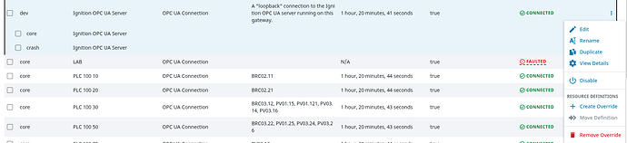

Hello,
I am configuring development modes. I have two instances dev and crash. I sync via git from dev to crash.
I configure everything in dev and move it to crash, which is a playground. When I sync, I overwrite everything in crash.
I am configuring local loopback OPC connection. On dev the server is on 62542 port and on crash it is at 19542. I create override I cannot set directly I get:
Error retrieving discovery server information for endpoint Url 'opc.tcp://localhost:19542
Of course. I use advanced, I set, OK. I sync to crash, I get:
UaException: status=Bad\_ConfigurationError, message=no matching endpoints found
Wierd. There is no endpoint setting:
 ![image](https://us1.discourse-cdn.com/inductiveautomation/original/3X/8/8/885f718c2cba528e97548ed76efc58fed7f1a22a.png)
When I go back to dev, I see there is no endpoint setting on the active dev override. But I can see endpoint setting on the non active crash override.
 ![image](https://us1.discourse-cdn.com/inductiveautomation/original/3X/0/2/02c1f032c6d40a3c9b05b05f42203abca1cb8318.png)
 ![image](https://us1.discourse-cdn.com/inductiveautomation/original/3X/6/a/6a27ff5bf5184825b6be31b0474d3ec846f677bc.png)
I think it worked day before yesterday. It is weird I cannot edit active’s dev override endpoint.
Any ideas where to go?

I delete all Override and I see Endpoint settings:
 ![image](https://us1.discourse-cdn.com/inductiveautomation/original/3X/5/6/5676c5c9d92644cecb115ec84d289cd171c3a11e.png)
I click Create Override for dev (active), it connects, but I cannot edit Endpoint anymore.
 ![image](https://us1.discourse-cdn.com/inductiveautomation/original/3X/f/4/f401a26132c1f4b5ba6955687a01cb61474459d2.png)
Is this a BUG? Or how it should work?

This issue with overrides for OPC UA connections not showing the endpoint option should be resolved in the upcoming 8.3.2 version. There is currently an [early release candidate 8.3.2-rc1](https://inductiveautomation.com/downloads/ignition/8.3.2-rc1) that should have this fix currently in as testing it on my end I can see the available endpoint option for the deployment mode.

Still missing in 8.3.3?
There is no way to initiate the override endpoint (as we can with new OPC connections).

Yes, 8.3.3 the problem persists. I cannot modify active connection. Which is very impractical. The active override must be deleted, then modify the core override, then create the active override again from the modified core override, then correct the core override.

For disabled active override, no option to modify the connection.
 ![image](https://us1.discourse-cdn.com/inductiveautomation/original/3X/d/0/d0b949e1512e4ad8642912cea33722d560138bd0.png)
I have to remove the active override (prod here), then modify the core override and then create the override again. Then reset the core override to original values.
