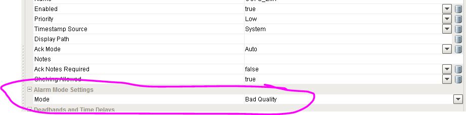

After configuring new modbus TCP device in gateway
1. \*Modbus tcp device unplugged status in gateway=disconnected:
2. Modbus TCP device plugged in status in gateway= connected
3. Modbus TCP device unplugged after " connected" status always shows as connected.
My intent is to detect if device offline and Ignition alarm.
Device has a webserver and gave TCP driver a try. In gateway status of device will mirror physical device.
However The “Is Connected” Quality = Good, after initial connection to device. Status doesn’t change regardless of physical state of device.
The “Message” Quality= matches physical state of device.

Trial and error found that to get repeatable alarm based on physical state of device:
TCP driver(port is important) + Used “Message” tag alarm Mode settings mode= Bad Quality.🙂
To reiterate the “Is connected” tag value and even “Quality” didn’t appear to be linked to physical state of device.😕

**Post date:** [June 5, 2019, 6:38pm UTC](https://forum.inductiveautomation.com/t/device-connection-status-always-connected-after-initial-connection/15870/5 "2019-06-05T18:38:28Z")
![BadQuality](https://us1.discourse-cdn.com/inductiveautomation/original/2X/2/22a3e0f9d5f03f3e3335fbedf6186b2d030cc13b.jpeg)
