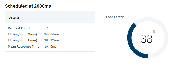

Hi there, If the request count per sec is more than the throughput (1 min), does that mean that the tag update will be slower?
 ![Capture](https://us1.discourse-cdn.com/inductiveautomation/original/2X/3/338c49800eb59245c6b611d9acf6c0b8e9ff8c98.png)

Yes, normally. But your displayed load factor suggests there’s some other optimization impacting your case.
**Post date:** [May 6, 2020, 12:28pm UTC](https://forum.inductiveautomation.com/t/device-status-request-count-throughput/34475/3 "2020-05-06T12:28:07Z")
The throughput suggests your tags subscribed @ 2000ms are updating just a little slower than that.
Load Factor is a strange calculation that I’d like to replace eventually. It’s calculated like this, using the 50th percentile from the histogram:

var loadFactor = Math.round(histogram['p50'] * requestCount / concurrentRequests / rate * 100);
Basically… it’s a crude measurement of the remaining “capacity” of the connection based on the 50th percentile request/response latency. I’m not convinced it’s very useful or accurate any more, and it seems to fall apart when concurrentRequests \> 1 and/or there are multiple rate groups.
**Post date:** [May 6, 2020, 12:34pm UTC](https://forum.inductiveautomation.com/t/device-status-request-count-throughput/34475/4 "2020-05-06T12:34:09Z")
It also doesn’t account for writes or out-of-band traffic (system.opc.\*).

One more question @pturmel or @Kevin.Herron,
I tried to look at the manual for the meaning of “Tag Count” but couldn’t find it…
Tag Count means the total no. of tags for the Request Count?
Cheers
**Post date:** [May 8, 2020, 12:12pm UTC](https://forum.inductiveautomation.com/t/device-status-request-count-throughput/34475/6 "2020-05-08T12:12:23Z")
Basically, yes. Subscribed items, typically Ignition’s OPC tags. Can also be elements in a SQL Bridge transaction group.
