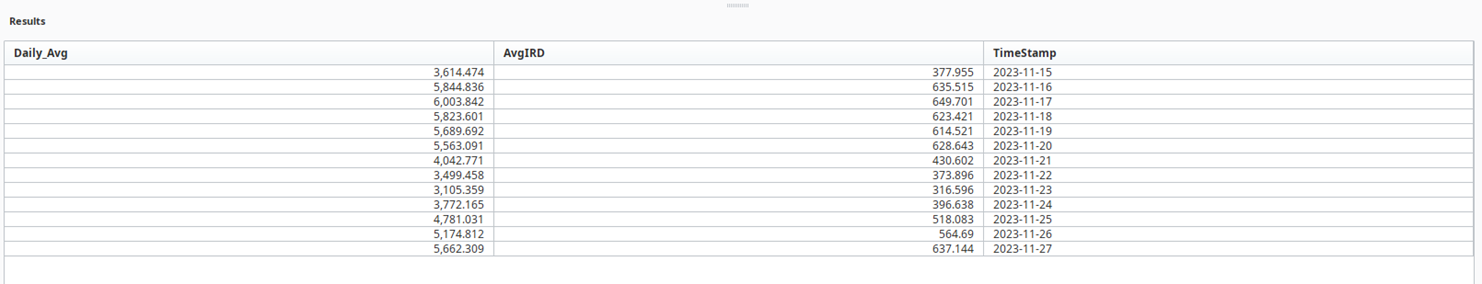

I ran a query to retrieve data from the same table in MSSQL and in ignition "Named queries" but the results were not the same. Therefore, I did a manual calculation using Excel and it was matched with MSSQL output.
> I wanted to get monthly averaged data from the table\<
> Same as I ran the query per monthly(one by one) on Ignition DB and those values were matched with MSSQL output.
> What could be the reason?
> Query
> ![image](https://us1.discourse-cdn.com/inductiveautomation/original/3X/5/e/5ea796651da44e7ac8cc176e74d054c7d1d27a8f.png)
> MSSQL Output
> ![image](https://us1.discourse-cdn.com/inductiveautomation/original/3X/3/1/313eaffbdf66cd048eb22724ae22e00f4d4e9386.png)
> Ignition DB Output
> ![image](https://us1.discourse-cdn.com/inductiveautomation/original/3X/6/7/671687397d52c670eaf50bdfcba9fca5264633c7.png)

It looks like we are dealing with three fields on which you want to perform some aggregate functions and miscellaneous functions. Ignition is not the best at handling complex SQL, so I would create a stored procedure that returns the dataset you are looking for. You might be able to create a function (?) to handle the formatting and conversion of the field `t_stamp` as well.
Your named query then would call the SP, passing any parameters as needed.
e.g. `EXEC usp_MyAveragePower :param1, :param2`

I dont have any parameters to send. I need to get the average values of some data which is needed for another mathematical calculation.

I found a way to create a SP in the MSSQL and called it through Named Queries. It worked.
Thank you very much
