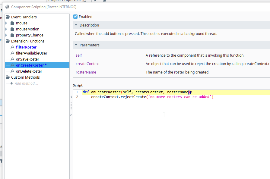

Hello,
I am trying to disable the add roster button and delete roster button in the roster management component in vision (user are not supposed to add or delete rosters). how is that possible?
Thanks,

Are you allowing users to edit rosters? But not create or delete?
If they can’t edit it at all, you can just disable user management from project properties for their user level.
I don’t think you can disable add,delete but allow edit. So a workaround might be covering said button with an object so it can’t be seen or clicked.

The add and delete buttons aren’t available through scripting. The best you can do without creating your own component is to use the onCreateRoster and onDeleteRoster extension functions to disallow the action when the user presses the button, or like @andrews said, cover the buttons with something.

you can add scripts in OnCreateRoster and onDeleteRoster
 ![image](https://us1.discourse-cdn.com/inductiveautomation/original/3X/4/e/4e8afc37f83f67077347a39f777bb5cd7f6a0752.png)
