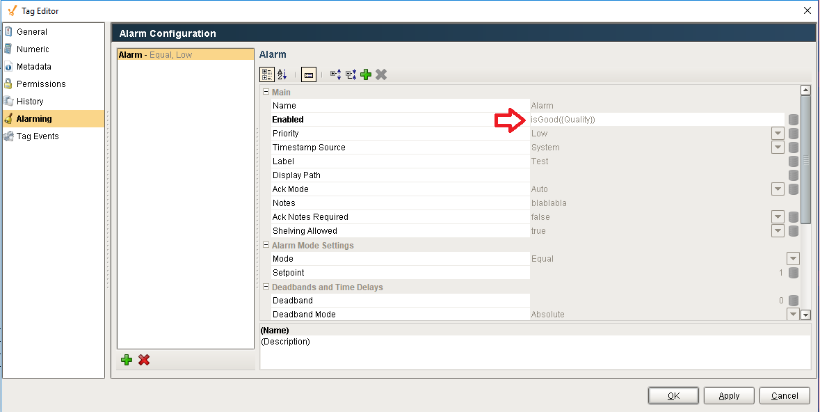

I try to bind an expression on Enable parameter of tag alarm to disable the alarm when the tag quality is not Good
I tried the following methods but the behavior does not work properly.
{Quality} = 192
{Quality} = “Good”
isGood({Quality})
 ![image](https://us1.discourse-cdn.com/inductiveautomation/original/2X/a/a0e446894d89ecd8017aa82183c4ebcf4f9bc51c.png)

You can use:
`toStr({Quality}) = 'Good'`
**Author:** ![EricProvBRP](https://sea1.discourse-cdn.com/inductiveautomation/user_avatar/forum.inductiveautomation.com/ericprovbrp/32/6352_2.png) [@EricProvBRP](https://forum.inductiveautomation.com/u/EricProvBRP)\
**Post date:** [May 19, 2020, 5:05pm UTC](https://forum.inductiveautomation.com/t/disable-alarm-on-bad-quality/34782/3 "2020-05-19T17:05:01Z")
Sorry, but it doesn’t work on my side. The alarm did not display.
**Post date:** [May 19, 2020, 11:19pm UTC](https://forum.inductiveautomation.com/t/disable-alarm-on-bad-quality/34782/4 "2020-05-19T23:19:32Z")
Ah, I think I see the issue. The `{Quality}` tag is the quality at the time the alarm is evaluated. If it’s disabled, it can’t be evaluated, hence it will never become re-enabled.
You **can** use:
`toStr({[.]Test Alarm.quality}) = 'Good'`
or
`toStr(tag({fullItemPath} + ".quality")) = 'Good'`
