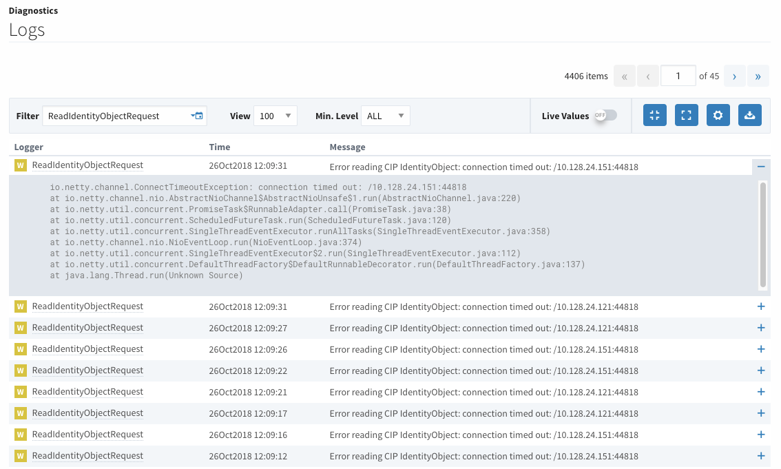

Hi all,
We are seeing a lot of error entries in the log about devices that are disconnected (due to PM, or power off). Is it normal to see these devices in the logs so often? We are managing a couple hundred devices and it’s not effective having to disable the devices when they are turned off.
 ![](https://us1.discourse-cdn.com/inductiveautomation/original/2X/6/6890d0830904ea05b370f38e3a30e85056069003.png)
Any ideas?
Cheers!
Oscar.
**Post date:** [October 26, 2018, 4:15pm UTC](https://forum.inductiveautomation.com/t/disconnected-device-errors-in-log/20402/2 "2018-10-26T16:15:58Z")
“Normal” but should be fixed in 7.9.9. What version are you on?
**Author:** ![oscar.salcedo](https://sea1.discourse-cdn.com/inductiveautomation/user_avatar/forum.inductiveautomation.com/oscar.salcedo/32/11019_2.png) [@oscar.salcedo](https://forum.inductiveautomation.com/u/oscar.salcedo)\
**Post date:** [October 26, 2018, 4:17pm UTC](https://forum.inductiveautomation.com/t/disconnected-device-errors-in-log/20402/3 "2018-10-26T16:17:59Z")
On 7.9.6
We are planning to upgrade soon, will keep that in mind.
Thanks!
