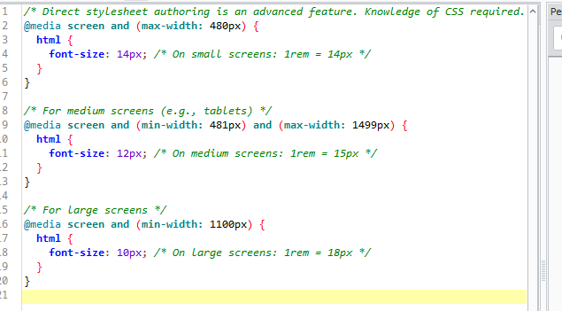

Hello I am trying to align the Toggle component in runtime but it is happening in runtime what settings i need to make to proper align them in perspective designer.
 ![image](https://us1.discourse-cdn.com/inductiveautomation/original/3X/a/9/a92fa5100d1ead8ad6e63a811add13ef4d5010cc.png)
Thanks
**Author:** ![pascal.fragnoud](https://sea1.discourse-cdn.com/inductiveautomation/user_avatar/forum.inductiveautomation.com/pascal.fragnoud/32/24728_2.png) [@pascal.fragnoud](https://forum.inductiveautomation.com/u/pascal.fragnoud)\
**Post date:** [July 23, 2025, 9:46am UTC](https://forum.inductiveautomation.com/t/disorder-of-toggle-switch-component-in-run-time/108811/2 "2025-07-23T09:46:50Z")
This looks like someone messed with the component's styles.
I'd check the stylesheet to see if there's something changing them.
**Author:** ![Kartik\_I](https://avatars.discourse-cdn.com/v4/letter/k/8c91f0/32.png) [@Kartik\_I](https://forum.inductiveautomation.com/u/Kartik_I)\
**Post date:** [July 26, 2025, 7:59am UTC](https://forum.inductiveautomation.com/t/disorder-of-toggle-switch-component-in-run-time/108811/3 "2025-07-26T07:59:41Z")
Hello @pascal.fragnoud I am not using any styles for that button the only stylesheet I used is this.
 ![image](https://us1.discourse-cdn.com/inductiveautomation/original/3X/c/8/c81cf06f1a60ffce89156f9992be0edd9daf6af8.png)
