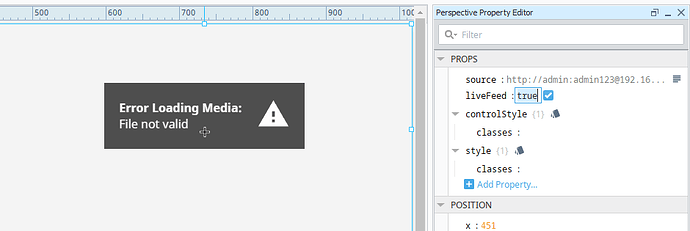

But when I paste the same URL into the **Ignition Perspective Video Player** as the source path, it shows the error **“File not valid.”**
My camera is **Milesight** and the video codec is **H.264**.
Please help me to display the live video in Perspective.

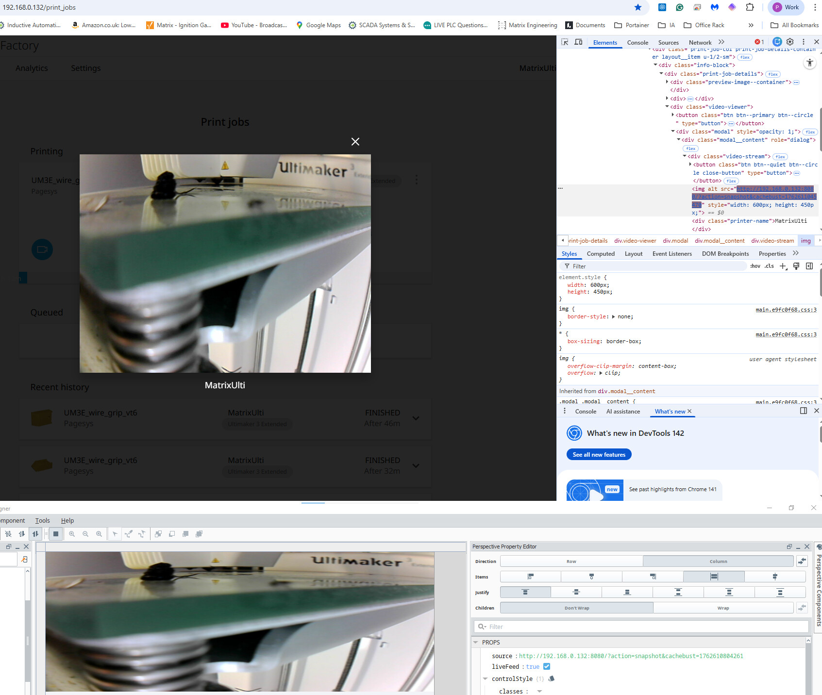

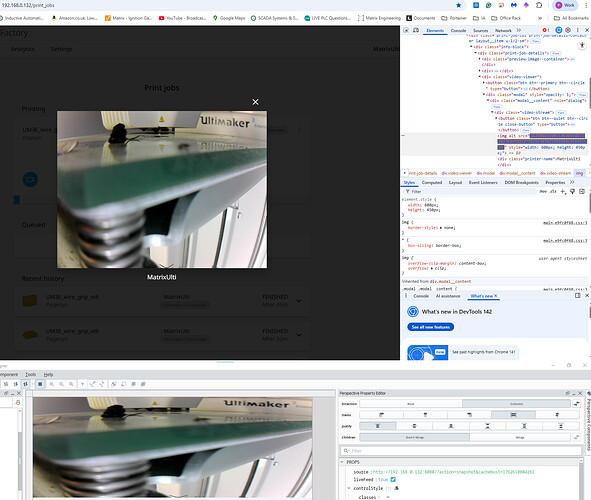

Did you tick “Live Feed: True”?
 ![image](https://us1.discourse-cdn.com/inductiveautomation/original/3X/f/c/fc9d63428126283f92d00e035a232a906209de15.jpeg)
**Author:** ![MOHAMMED\_MUSAMMIL](https://avatars.discourse-cdn.com/v4/letter/m/f1d935/32.png) [@MOHAMMED\_MUSAMMIL](https://forum.inductiveautomation.com/u/MOHAMMED_MUSAMMIL)\
**Post date:** [November 8, 2025, 2:24pm UTC](https://forum.inductiveautomation.com/t/display-live-feed-in-ignition-perspective/111989/6 "2025-11-08T14:24:29Z")
Yes sir
 ![Live1](https://us1.discourse-cdn.com/inductiveautomation/original/3X/4/a/4a10dfb1aa86ca3acb9be66f6c1433164d15caf8.jpeg)
 ![Live](https://us1.discourse-cdn.com/inductiveautomation/original/3X/9/5/95c34b7699411fc3627200e6acbe5642b4504cc9.png)
