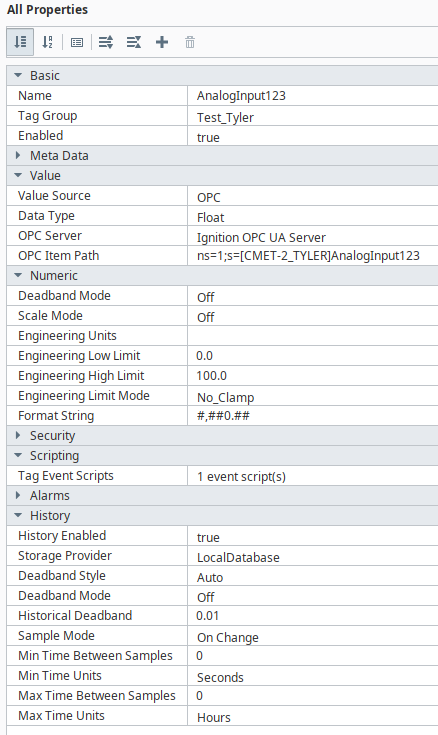

1. A tag group is being used with Sampling Interval set to zero (0) and queue size set at a arbitrary large number. Is there anything else significant for the tag group settings? I find the terminology around "MonitoredItem" to be unclear in [the manual](https://www.docs.inductiveautomation.com/docs/8.1/ignition-modules/opc-ua/opc-ua-drivers/dnp3/dnp3-driver).
**Tag Group:**
 ![image](https://us1.discourse-cdn.com/inductiveautomation/original/3X/7/7/776b56f49062ca4994430cafcd47bcf6130815b6.png)
**Tag Config:**
 ![image](https://us1.discourse-cdn.com/inductiveautomation/original/3X/2/e/2e278b98864a5411a41ef386d67eb60b44fbcc43.png)

Your timestamps look wrong or in the past... I'm not sure the history system will store any data with a past timestamp unless backfill is enabled.
