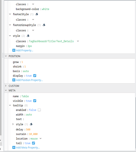

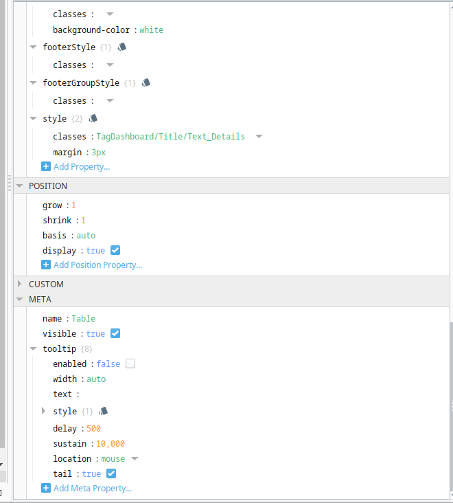

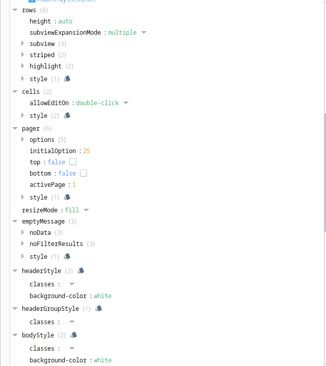

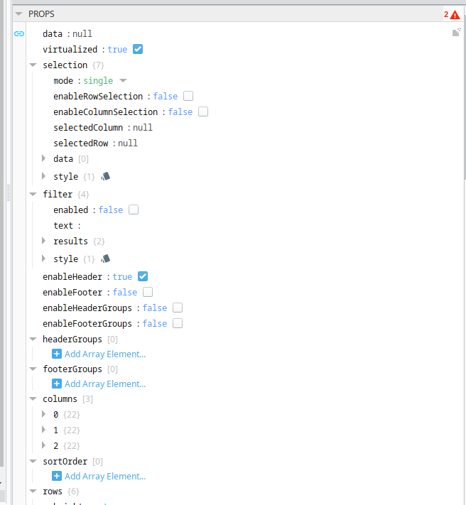

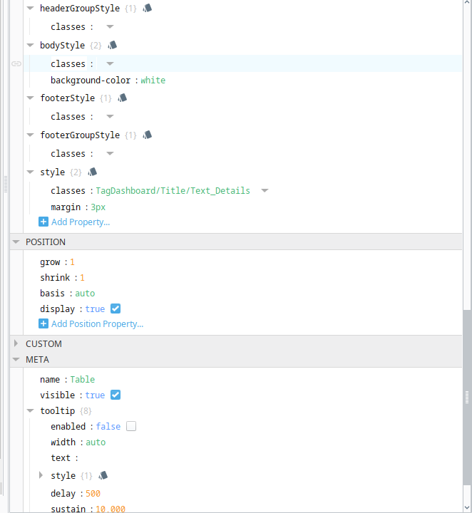

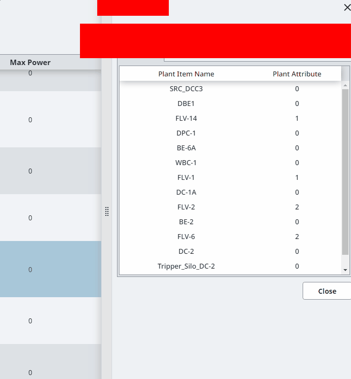

Table Column’s misaligned when data is changed.
![fefeferre](https://us1.discourse-cdn.com/inductiveautomation/original/3X/1/c/1c3c344f296a57894ecc14e47936088d14580a65.gif)

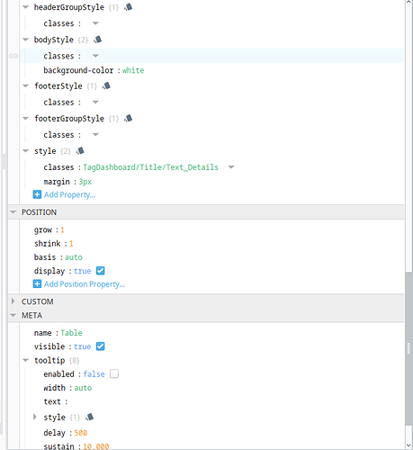

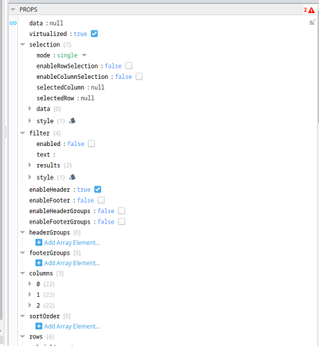

Table Props:
 ![image](https://us1.discourse-cdn.com/inductiveautomation/original/3X/0/f/0f6a912fd39323303d0203ca78d73da5edb80431.png)
 ![image](https://us1.discourse-cdn.com/inductiveautomation/original/3X/b/6/b615cd56de3b3b6b2a7b38ed252b4f8700388c30.png)
 ![image](https://us1.discourse-cdn.com/inductiveautomation/original/3X/5/4/5492fadc976f8187a329bb7916666e42399ab91b.png)
 ![image](https://us1.discourse-cdn.com/inductiveautomation/original/3X/b/2/b2539dbe1b2b03ad9fcf39337799183eed377844.png)

You can use the `width` property in the columns settings to ensure things don’t move.
It will be a percentage of the table width if `strictWidth` is false, or a fixed width in pixels if it’s true.
**Post date:** [June 22, 2022, 3:24pm UTC](https://forum.inductiveautomation.com/t/dock-view-table-column-misaligned-when-data-is-changed/61047/3 "2022-06-22T15:24:55Z")

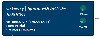

What Ignition version is this? I’m pretty sure a bug ticket exists for this, but I don’t know if it’s fixed already or not.
**Author:** ![chrisl](https://avatars.discourse-cdn.com/v4/letter/c/58f4c7/32.png) [@chrisl](https://forum.inductiveautomation.com/u/chrisl)\
**Post date:** [June 23, 2022, 12:36am UTC](https://forum.inductiveautomation.com/t/dock-view-table-column-misaligned-when-data-is-changed/61047/4 "2022-06-23T00:36:24Z")
version 8.1.12
version 8.1.14
 ![image](https://us1.discourse-cdn.com/inductiveautomation/original/3X/6/7/67e661f3d9ec100868203b80d5854a248477a227.png)
 ![image](https://us1.discourse-cdn.com/inductiveautomation/original/3X/a/0/a012e57314d6b976c9198c11f1b939a1c9a1da17.png)
**Author:** ![pascal.fragnoud](https://sea1.discourse-cdn.com/inductiveautomation/user_avatar/forum.inductiveautomation.com/pascal.fragnoud/32/24728_2.png) [@pascal.fragnoud](https://forum.inductiveautomation.com/u/pascal.fragnoud)\
**Post date:** [June 23, 2022, 8:15am UTC](https://forum.inductiveautomation.com/t/dock-view-table-column-misaligned-when-data-is-changed/61047/5 "2022-06-23T08:15:32Z")
Why do you have two different versions ? What’s what ?
**Post date:** [June 23, 2022, 8:22am UTC](https://forum.inductiveautomation.com/t/dock-view-table-column-misaligned-when-data-is-changed/61047/6 "2022-06-23T08:22:19Z")
@pascal.fragnoud 8.1.12 is the version in the main server while the 8.1.14 is my localhost ignition version. Bug can be reproduced in both versions. 🙂
I also tried your suggestion by using width property, same thing happens as before.
**Post date:** [June 23, 2022, 3:51pm UTC](https://forum.inductiveautomation.com/t/dock-view-table-column-misaligned-when-data-is-changed/61047/7 "2022-06-23T15:51:37Z")
Try 8.1.17+; I don’t know why there’s no public release note (so I can’t link you to anything to prove it) but I see a bug that I’m pretty sure is the same as what you’re seeing fixed in that version.
